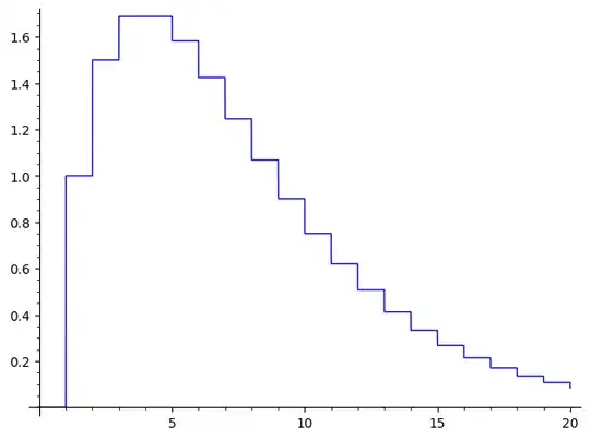

Here is a plot of $\mathbb{E}(X)= n\left(\frac{3}{4}\right)^{n-1}$:
Plot of n(3/4)^{n-1}

Notably, for $n\ge 9$, we have $\mathbb{E}(X) = n\left(\frac{3}{4}\right)^{n-1} < 1$.
This is a contradiction to the following argument:
  • Assume $n$ points placed in the unit square (never mind how they are distributed).
  • Since the set of points is finite, there exist at least one point with a maximal X coordinate, and at least one point with a maximal Y coordinate. (These points might be the same.)
  • Therefore the number of peripheral points is $X \ge 1$ always, and thus $\mathbb{E}(X)\ge 1$.
Put differently, if for $n\ge 9$ we have $\mathbb{E}(X) < 1$ then there should exist a configuration of points such that no point is peripheral. I can’t see how that is true?
Any help clearing up my confusion would be greatly appreciated, thanks!
