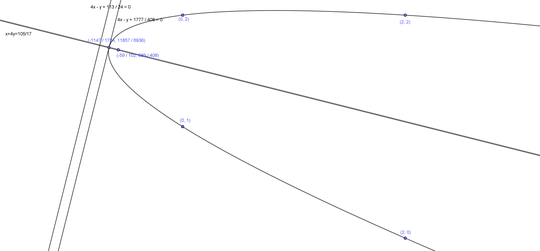

One way to find the axis is to write the equation as $(x+4y)^2-18x-48y+32=0,$ then you know the axis is parallel to $x+4y=0.$ The tangent at vertex is orthogonal and parallel to $4x-y.$ Now you can find where $4x-y+c$ intersects doubly to find the vertex. $$x^2+8x(4x+c)+16(4x+c)^2-18x-48(4x+c)+32=0$$ or $$289x^2+(136c-210)x+16c^2-48c+32=0$$ and this has discriminant $$(136c-210)^2-4\cdot 289\cdot (16c^2-4c+32)=(-4)(408c - 1777)$$ so the discriminant is zero for $c=\frac{1777}{408}.$ The vertex is the intersection of the tangent at vertex and the parabola. So solve $$x^2+8x(4x+\frac{1777}{408})+16(4x+\frac{1777}{408})^2-18x-48(4x+\frac{1777}{408})+32=0$$ or $$(1734x+1147)^2\frac1{10404}$$ and put back into the tangent at vertex to find $y.$ The vertex then is $(-\frac{1147}{1734},\frac{11857}{6936}).$ The axis goes through the vertex so the axis is $${ x+4y=\frac{105}{17}}.$$ As a bonus the tangent at vertex form is then $$(x+4y-105/17)^2=(96/(4\cdot 17))(4x-y+1777/408).$$ For fun I've also found the focus/directrix form $$17\cdot ((x+\frac{59}{102})^2+(y-\frac{689}{408})^2-(4x-y+\frac{113}{24})^2/17)=0$$
The parabola with axis/tangent at vertex and focus/directrix
