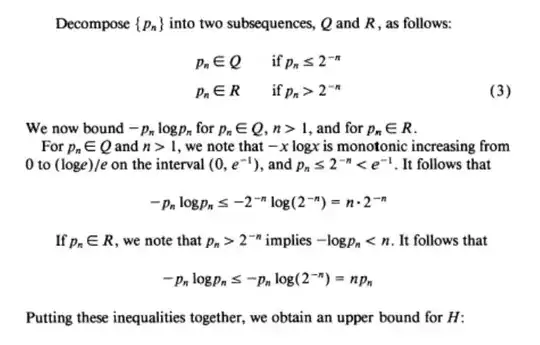

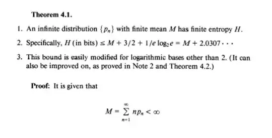

Finite mean implies finite entropy. The proof is in Golomb, Scholtz and Peile's book Information Theory:Adventures of Agent 00111 (Theorem 4.1). There are copies online if you dig around, I have no time to type in details, so with apologies I give the indications below:
Main idea of the proof:
The authors also note that since the mean is sensitive to rearrangements of the probability distribution sequence but the entropy isn't one can also show that if $\{p_n\}$ has infinite entropy all its rearrangements have infinite mean, but the converse does not hold.

    +1 I took the idea and translated it to nats, yielding $H(p)\le E(p)+\frac{1}{e-1}$, which gives a slightly worse bound than the bound obtained from Rioul's bound $E(p)+\frac{1}{2}$. – Matija Feb 06 '23 at 19:43
