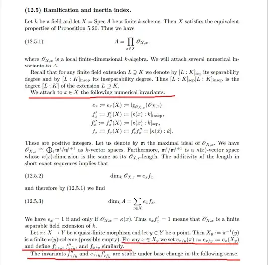

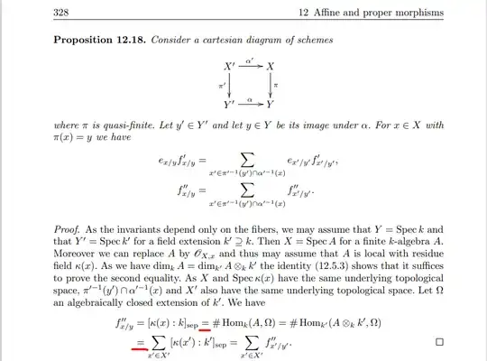

This question originates from proof of the Proposition 12.18 in the Gortz's book (as a reference, I also upload image which includes definitions of notations which are appeared in the proposition 12.18) :
(Note that the first formula in the Proposition 12.18 is false : refer to the p.328 in https://www.algebraic-geometry.de/errata/1/ )
I think that I understand the proof of Proposition 12.18 (If needed, I will upload details.) except the underlined statements. Why the below underlined equalities are true?
Can anyone helps?
