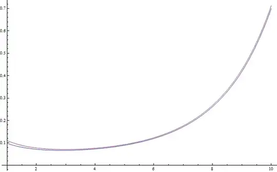

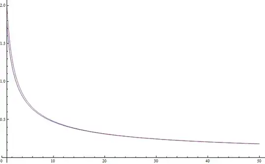

Below is a plot of $c_n$ in blue and this asymptotic in purple for $1 < n < 10$. Below that is a plot of $W(n)^{-n-1} e^{n/W(n)} c_n$ in blue and $\sqrt{\frac{2\pi}{n(1+W(n))}}$ in purple for $1 < n < 50$.
