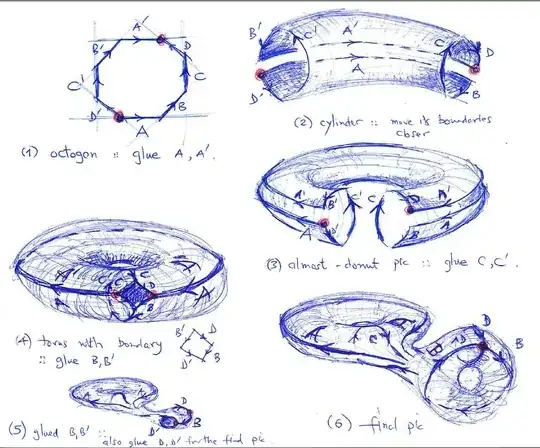

First picture:
MSE 4628485 genus two surface octogon with identified sides
This first picture shows roughly the strategy of glueing the sides of the starting octogon, as depicted in $(1)$ above. Denote the resulted space by $X$. We stretch both opposite $A$-sides, and form a cylinder after glueing them. Before doing so, it is convenient to also place the two $C$-side close to each other, they are coming next in the glueing process. So after closing the $A$-slit, then the $C$-slit, we have the surface of a torus, with a square cut, the opposite sides of the square still to be glued. This can be done, and some undetailed doodle shows how the second hole comes into play. We expect this, but the question is now how do the paths $A,B,C,D$, which are now closed, live in the picture.

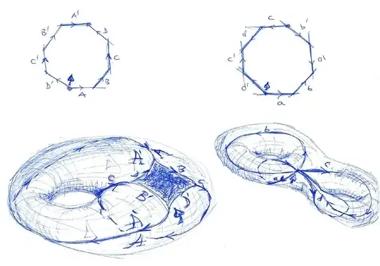

Third drawing:
MSE 4628485 genus two surface octogon with identified sides :: two ways to do it :: compare the ways
This third drawing repeats the steps from the first picture, but the focus is on the correct placement of the paths $A$ and $C$. For clarity, only $A$ was finally drawn. Some words on the above. We start as in the first picture with the octogon $(1)$ with opposite sides identified, this time also showing how the vertices move in the pasting process, so stretch the $A$ sides first, get them closer, close their slit, then the same with the $C$-sides, we have a torus with some square removed, opposite sides of the square still to be identified, and we redraw $(3)$ by making more room for this square with vertices $16$, $47$, $25$, $38$ on the upper surface of the torus. In position $(4)$ we want to identify first the $D$-sides. For this process take some more material from the torus below the $D$ side from $16$ to $38$, and push $D$ somehow "parallely" to itself to get it closer to the position between the oder $D$ side between $47$ and $25$ in the picture. Do not overlap the rubber surfach, instead push the corner $16$ inside the square hole towards $47$, same game for $38$ towards $25$, so that finally the $B$-sides become circle paths in position $(5)$.
In the obtained position $(5)$ we have two boundaries, two holes in the surface of the torus. Collect some more material from the surface of the torus, and let the circular holes slightly grow on some small hills. Now let these hills grow higher in the ambient space, we want them to get closer at some point and glue the two closed $B$-paths with each other. After all, we reach position $(6)$.
This position is now easily compared with the standard picture $(7)$ for the other octogon with sides identified w.r.t. the glueing scheme $[a,b]\;[c,d]=1$. In $(7)$, the genus two surface has two parts, the left one whith paths $a,b$, and the right one with paths $c,d$ as drawn. We already imagine them on the surface in $(6)$.
How does $A$ translate in terms of $a,b,c,d$? First of all, $A$ takes a trip around the left donut, as $b$ does. So $A=bx$. What is the remained path $x$ doing? It goes behind the first/left, behind the second/right hill, climbs this second/right hill on the hidden side, then closes the contour. Imagine it now doing the same in a more slow way, and let it make this trip after going behind the first hill by coming out first between the hills, closing the path, which is a $d$-path (after moving it in the "second ring"), and the remained trip is equivalent to a $c$-trip.
This gives the translation of $A$ as $A=b\cdot dc$.
Do now the same with $C$. By design, $C$ comes down on the second hill first, using the front wall. This is half of $\bar c$, so close the $\bar c$ trip by force, and after doing so, the new trip of $C$ starts from the same point, going down on the first hill on its front side, as $A$ did some minutes ago. But now, the ant on the $C$ path prefers to follow the $a$ circuit, and after all the path is closed with a $d$ path.
This gives the translation of $C$ as $C=\bar c\cdot a\cdot d$.
The translations of $B,D$ are easy, they are $\bar d$ and $c$.
So we have the following Ansatz for a map $\varphi$ from $G$ to a quotient group of $K:=\langle a,b,c,d\rangle$, $$ \begin{aligned} A&\to bdc\ ,\\ B&\to \bar d\ ,\\ C&\to \bar cad\ ,\\ D&\to c\ . \end{aligned} $$ Then: $$ \begin{aligned} ABCD\ \bar A\bar B\bar C\bar D & \to bdc\cdot\bar d\cdot \bar cad\color{red}{\cdot c\cdot \bar c}\bar d\bar b\cdot d\cdot \bar d\bar a \color{red}{c\cdot \bar c} \\ &= bdc\cdot\bar d\cdot \bar ca\cdot\color{blue}{d\bar d}\bar b\cdot \color{blue}{d\cdot \bar d}\bar a \\ &= bdc\cdot\bar d\cdot \bar ca\bar b\cdot \bar a \\ &= b\ [d,c]\;[a,\bar b]\ \bar b\ . \end{aligned} $$ The map $\varphi$ thus brings $ABCD\ \bar A\bar B\bar C\bar D$ into "a version" of $[a,b]\; [c,d]$, more exactly, it is a conjugate of $[d,c]\;[a,\bar b]$. So by construction, we obtain first a map from $G$ to $K$ modulo $[d,c]\;[a,\bar b]$ (following the topological insight), and can finish the algebraic problem by further composing with the appropriate map: $$ \left\langle \ A,B,C,D\ \Big|\ ABCD\ \bar A\bar B\bar C\bar D\ \right\rangle \overset\varphi\longrightarrow \left\langle \ a,b,c,d\ \Big|\ [d,c]\;[a,\bar b]\ \right\rangle \longrightarrow \left\langle \ a,b,c,d\ \Big|\ [a,b]\;[c,d]\ \right\rangle \ . $$
