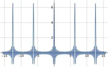

Noting the Dirac comb $\operatorname{\text{Ш}}_{2 \pi}(t)$ is $2\pi$ periodic as illustrated in Figure (1) below, the following table illustrates the contribution of the tooth at $t=0$ and the first 5 teeth in the right-half plane for the case $f_2(t)=\tan(t)-2 t$ (corresponding to $x=2)$.
$$\begin{array}{cc} k & \int\limits_0^{\frac{\pi }{2}} \delta(f_2(t)-2 \pi k) \, dt \\ 0 & 0.225523 \\ 1 & 0.0119339 \\ 2 & 0.00413686 \\ 3 & 0.00208941 \\ 4 & 0.00125876 \\ 5 & 0.000840887 \\ \end{array}$$
Note the row for $k=0$ in the table above gives the correct result since Mathematica ignores the partial contribution of an analytic representation at $t=0$. Also note the contribution of each successive tooth in the right-half plane decreases in magnitude which is because the slope of $f_2(t)=\tan(t)-2 t$ increases rapidly as $t$ approaches $\frac{\pi}{2}$.
Illustration of formula (2)
Figure (1): Illustration of formula (2) for $\operatorname{\text{Ш}}_{2 \pi}(t)$ evaluated at $N=20$

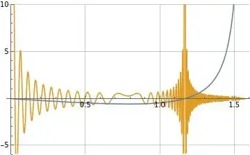

Figure (2) below illustrates $f_2(t)=\tan(t)-2 t$ in blue and $\delta(f_2(t))$ in orange using the limit representation
$$\delta(t)=\underset{N\to\infty}{\text{lim}}\left(2 N\, \text{sinc}(2\, \pi N\, t)\right)\tag{4}$$
evaluated at $N=20$. Note $\delta(f_2(t))$ has a $\delta$-function spike at $t=0$ as well as at $t\approx 1.16556$ corresponding to the two zeros of $f_2(t)$.
Illustration of f_2(t) in blue and formula (4) for delta(f_2(t)) in orange
Figure (2): Illustration of $f_2(t)=\tan(t)-2 t$ in blue and formula (4) for $\delta(f_2(t))$ in orange

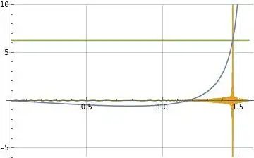

Figure (3) below illustrates $f_2(t)=\tan(t)-2 t$ in blue and $\delta(f_2(t)-2 \pi)$ in orange which corresponds to the first tooth of the Dirac comb in the right-half plane using the limit representation of $\delta(t)$ defined in formula (4) above evaluated at $N=20$. Note the $\delta$-function spike where $f_2(t)$ evaluates to $2 \pi$ (corresponding to the horizontal green reference line).
Illustration of f_2(t) in blue and formula (4) for delta(f_2(t)-2 pi) in orange
Figure (3): Illustration of $f_2(t)=\tan(t)-2 t$ in blue and formula (4) for $\delta(f_2(t)-2 \pi)$ in orange

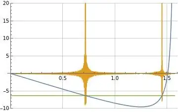

As $x$ grows larger, the integral $\int\limits_0^\frac\pi2\operatorname{\text{Ш}}_{2 \pi}(f_x(t))\,dt$ will also begin to pick up contributions from teeth of the Dirac comb $\operatorname{\text{Ш}}_{2 \pi}(t)$ in the left-half plane. For example, Figure (4) below illustrates $f_{10}(t)=\tan(t)-10 t$ in blue and $\delta(f_{10}(t)+2 \pi)$ in orange which corresponds to the first tooth of the Dirac comb in the left-half plane using the limit representation of $\delta(t)$ defined in formula (4) above evaluated at $N=20$. Note the two $\delta$-function spikes where $f_{10}(t)$ evaluates to $-2 \pi$ (corresponding to the horizontal green reference line).
Illustration of f_{10}(t)=\tan(t)-10 t in blue and formula (4) for delta(f_{10}(t)+2 \pi) in orange
Figure (4): Illustration of $f_{10}(t)=\tan(t)-10 t$ in blue and formula (4) for $\delta(f_{10}(t)+2 \pi)$ in orange
