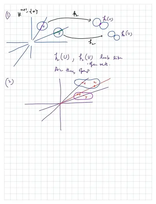

Suppose that $[x], [y]\in Y, [x]\ne [y], [l]$ denotes equivalence class of $l$. It follows that $p(x)=[x], p(y)=[y]$. Since $[x]\ne [y]$, it follows that $x\ne my$ for any $m\in \mathbb R-\{0\}$. (i.e., $x$ and $y$ cannot lies on the same line through the 'removed' origin.) $\mathbb R^{n+1}-\{0\}$ is Hausdorff so there exist $U, V$ disjoint open in $\mathbb R^{n+1}-\{0\}$ such that $x\in U, y\in V$.
Now, the following two things are to be shown:
  1. $p(U), p(V)$ are open.
  2. $p(U)\cap p(V)=\emptyset$
I have tried to show that 2) is true as follows: Suppose on the contrary that $p(U)\cap p(V)\ne\emptyset$. There exists $t\in p(U)\cap p(V)$. There exist $u\in U, v\in V$ such that $t=p(u)=p(v)\implies u=mv$ for some non zero real no. $m.\implies u,v$ lie on the same straight line through the origin. This contradicts the fact that $U, V$ are disjoint and that $U,V$ is 'centered' at different lines. But in view of red line in picture no. 2) in the picture below, this seems wrong. enter image description here
About $(1)$, I tried to use the definition of quotient maps: $p_2(U)$ is open iff $p_2^{-1}(p_2(U))$ is open. But since $p_2^{-1}(p_2(U))\ne U$, I'm not sure how to do this either.

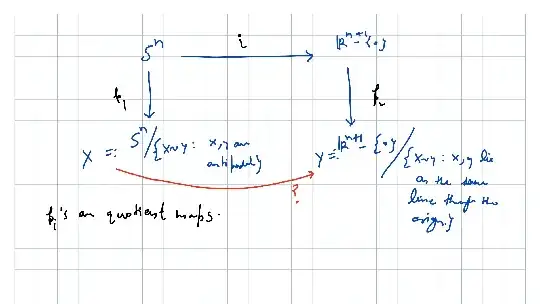

I tried to show the homeomorphism using the following picture: enter image description here
Here, if I show that $Y$ is Hausdorff, then the induced map $p_2\circ i: S^n\to Y$ due to being onto continuous from compact $S^n$ to Hausdorff $Y$ will turn out to be a quotient map. This quotient map partitions $S^n$ into equivalence classes of antipodal points, so by the property of quotient maps, it follows that $X$ is homeomorphic to $Y$. But here the problem is in proving that $Y$ is Hausdorff, and this is what led me to ask this question.

  • I think that 2) can be taken care of by choosing $U$ and $V$ very small so that $u$ and $v$ can't be joined by a straight line through the origin. But I still have no idea about how to show 1). – Koro Jan 28 '23 at 06:40
This is correct, but it does not help you because you cannot expect that $p(U) \cap p(V) = \emptyset$. Your picture (2) gives a counterexample. By the way, one can show that $p$ is an open map, but this is somewhat tedious and above all unnecessary.
Anyway, you cannot take arbitrary open neighborhoods of $x$ and $y$, but have to make a careful choice.
Your observation that we can identify $Y$ with $S^n/{\sim}$, where $\sim$ identifies antipodal points, is a much better approach. Now look at Brian M. Scott's answer to How can I prove formally that the projective plane is a Hausdorff space? to see how to choose $U, V \subset S^n$.

  • Thanks for the answer. Unfortunately, I still don't understand the answer to my question (why is $Y$ Hausdorff?). I'll explain: a) I think that the issue in picture titled 1) can be resolved by taking U and V very small. The intuition tells that doing so will ensure that no point in U can be joined to a point of V via a straight line through the origin. b) The linked answer: I am comfortable with the answer but it shows Hausdorffness of $S^n$/~, which is denoted by space X in my post. But I want to show it for $Y$ and as I mentioned in the post, I have not yet shown X and Y to be homeomorphic. – Koro Jan 28 '23 at 18:13
  • But I think that you suggest the following in your answer (Is my understanding correct that you suggest the following): Instead of taking the inclusion map i, I take the map $g:R^{n+1}-{0}\to S^n: x\mapsto \frac x{|x|}$. So in the new diagram, the second picture (the one towards the end of the post): $S^n$ and $X$ appear on the right; $R^{n+1}-{0}$ and X on left, $p_1,p_2$ remain as it is, whereas $i$ is replaced by $g$. Now using the linked answer, X is Hausdorff. And the map $p_1\circ g$ is onto continuous. And this is the point where I get stuck. (Contd.) – Koro Jan 28 '23 at 18:20
  • This is because in the earlier case (the case in post), we have $p_2\circ i:S^n\to Y$, which will be onto continuous from a compact set S^n to a Hausdorff space Y (if Y has been proven to be Hausdorff), and there is a theorem that guarantees that in such a case, $p_2\circ i$ must be a quotient map. So I consider the 'triangle' $S^n X Y$ and conclude that the map induced by $p_2\circ i$ from X to Y is a homeomorphism. But in the case in my last comment, I have $p_1\circ g$ from $R^{n+1}-{0}$ to X, and since $R^{n+1}-{0}$ is not compact, (Contd.) – Koro Jan 28 '23 at 18:25
  • I don't understand how to conclude $p_1\circ g$ to be a quotient map. – Koro Jan 28 '23 at 18:28
  • Thanks a lot :-). In your linked answer, the part showing that $U$ and $V$ are disjoint open with the property $\pi^{-1}(\pi(W))=W$, where W=U or V clears much of my confusion. We get a 'double cone' with its apex removed and indeed it is open. So my question has been answered. Thanks a lot. – Koro Jan 28 '23 at 19:18
