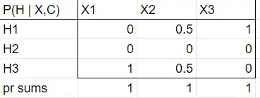

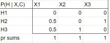

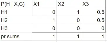

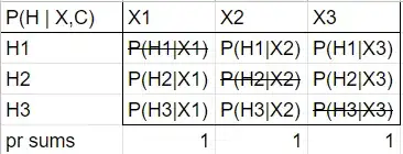

Suppose the player chooses Door 1, and the prize is indeed behind Door 1. Which of the other two doors will Monty Hall open? Each has a probability of 1/2.
Using
we can construct three tables by collapsing/conditioning our model:
$$P(C_1) = 1$$
$$P(C_2) = 1$$
$$P(C_3) = 1$$
If we restore the sample space, we have the probabilities for all the entries $P(H|X)$ by scaling them with $P(C_1) = P(C_2) = P(C_3) = \frac{1}{3}$.
We have
$P(H_3|X_1) = P(H_3|X_1,C_1) + P(H_3|X_1,C_2) + P(H_3|X_1,C_3) = $
$\quad \quad \quad \quad \quad \quad 0.5 \cdot \frac{1}{3} + 1 \cdot \frac{1}{3} + 0 \cdot \frac{1}{3} = \frac{1}{6} + \frac{1}{3} = \frac{1}{2}$
