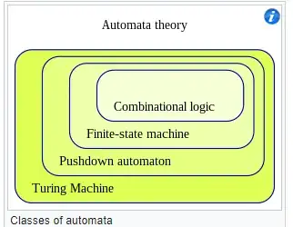

In the Wikipedia article on Automata theory there is a diagram that suggests that combinational logic recognizes a proper subset of the languages that a regular expression recognizes. Is this in fact the case?
Wikipedia Automata Diagram

The set of languages which can be recognised by combinational logic (to the extent that it's reasonable to talk about languages being recognised by combinational logic) is a proper subset of the set of languages recognised by DFAs. However, the two sets have the same cardinality ($\aleph_0$); both are isomorphic with $\mathbb{N}$.
Unlike DFAs and the other automaton in that diagram, combinational logic automaton have no way of dealing with sequential input. Every combinational circuit has a predefined finite number of boolean inputs. That allows the construction of a combinational circuit for any finite language. Every finite language is regular, but not all regular languages are finite. Hence, the set of finite languages is a proper subset of the set of regular languages.
A finite language with alphabet $\Sigma$ can be precisely described as a finite string by adding two symbols to the language ("separator" and "end-marker") and then listing the members in some order, separated by the separator and terminated by the end-marker. Each such representation corresponds to some natural number written in base $|\Sigma|+2$. That's similar to the representation of an arbitrary regular language by writing out its regular expression, also using an alphabet which augments $\Sigma$ with a few special characters.
That's not a one-to-one mapping; a strict proof of the assertion that both of these sets are isomorphic to $\mathbb{N}$ is left as an exercise. (But see this question if necessary.)

  • All formal languages with finite alphabets and finite length strings are countable. That isn't something that is peculiar to DFAs and combinational logic. – Q the Platypus Jan 17 '23 at 00:57
  • Can you give an example of a language that can be recognized by a DFA that could not be recognized by combinational logic? – Shadow43375 Jan 17 '23 at 01:20
    @Shadow43375 How about the language $a^*$ over the alphabet ${a,b}.$ Any combinational logic automaton has a limit to how many characters of input it can read (due to the finite number of boolean inputs mentioned above). – David K Jan 17 '23 at 03:26
  • @QthePlatypus: I'm not talking about particular formal languages. What I said is that the set of all regular languages is countable. That's not a particularly profound statement, but I think it's more interesting than the statement that every regular language is countable. The set of all formal languages (that is, the set of subsets of ${0, 1}^*$) is certainly not countable. But the set of all (finite) grammars is countable, and therefore so is the set of all formal languages described by a generative grammar. (And, indeed, that goes beyond just finite and regular languages.) – rici Jan 17 '23 at 04:12
