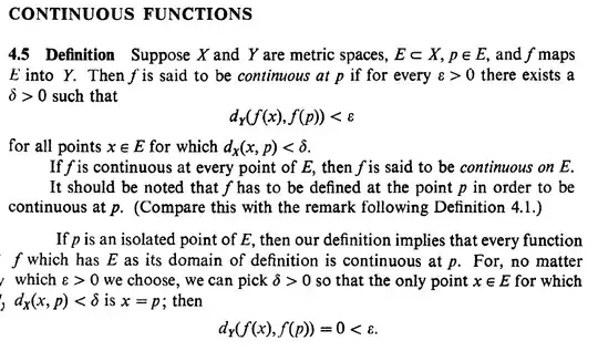

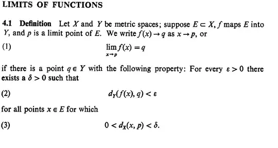

What's the difference between two concepts, 1. limit of function and 2. continuous function? I looked at their definitions in the textbook written by Rudin and it's so hard to differentiate between them.
They look similar to me.
[Edited] I can't find the difference between two definition. If they are the same, it means that a function is continous if and only if every point is a limit point. But this is not true. So I want to know what makes a difference between a point being a limit of function and function being itself continuous
Images of Definitions

  • @CameronBuie My question is that I can't find the difference between two definition. If they are the same, it means that a function is continous if and only if every point is a limit point. But this is not true. So I want to know what makes a difference between a point being a limit of function and function being itself continuous – user86261 Aug 07 '13 at 03:41

  • Now that you've posted your definitions, it's even clearer that your post is indeed a duplicate of the other. The other user simply noticed the only difference between the definitions of function limit and continuity at a point. (Note the difference between continuity at a point and being a continuous function. Also, did you compare with the remark after definition 4.1?) Rudin's definition does not imply that every point of the domain is a limit point, as he proceeds to explain after Definition 4.5 ("It should be noted....") – Cameron Buie Aug 07 '13 at 05:38

  • While the definition $4.1$ does not require that $f(x)$ is defined at $p$, the definition $4.5$ requires that $f(x)$ is defined at $p$. Moreover the definition $4.5$ requires that $lim_{x \rightarrow p} f(x) = f(p)$. – Makoto Kato Aug 07 '13 at 07:56
The limit (if it exists) is the number the function approaches. In precise terms $L$ is the limit of $f$ at $a$ if for every $\epsilon > 0$, there is a $\delta > 0$, so that for every $x$, $0 < |x - a| < \delta \implies |f(x) - L| < \epsilon$. When the function is continuous at $a$, the number it approaches at $a$ is $f(a)$. So in the definition above, $L$ is replaced by $f(a)$. You can also change the first part to $|x - a| < \delta$ since the statement is clearly true for $x = a$ also. That's why the definitions look so similar.
In the book, notice that for limits, it uses a general variable $q \in Y$ but for continuity, it is replaced with $f(p)$.
