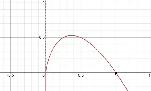

How do I prove that whenever $|y − x| ≤ 1/2$ it follows that $|f(y) − f(x)| \leq f(|y − x|)$ given $f(x)=-x\log_2 x$?
where $x,y\in[0,1]$
The graph of $f(x)=-x\log_2 x$ function is
-xlogx

  • @AdityaDhawan How do we prove $f(z)\geq f(1-z)$ ? I can see that from the graph though. – SOORAJ SOMAN Jan 12 '23 at 21:46
  • The standard approach would be to look at the derivative, as @AdamZalcman has done. – Aditya Dhawan Jan 13 '23 at 05:59

  • Nice +1. I had the same proof in mind except that i could not prove $f(1-x) \leq f(x)$ for $0<x<1/2$. Any simple proof you have in mind for this ? –  Jan 11 '23 at 04:08
    @Balajisb Well, the simplest is probably to look at the plot, but if you prefer something more rigorous, here's one idea: Let $\Delta(x)=f(x)-f(1-x)$ and note that $\Delta'(x)=-2-\log(x(1-x))$. For $x\in[0,1]$ we find three zeros $\Delta(0)=\Delta(\frac12)=\Delta(1)=0$ and two extrema (since $\Delta'(x)=0$ leads to a quadratic equation with two roots). Also, for $x$ slightly less than one half we have $\Delta(x)>0$ since $\Delta(x)=\int_x^{1-x} (1+\ln t) dt$ and the integrand is positive because $1/e < 1/2$. Thus, $\Delta(x)$ is non-negative for $x\in[0,\frac12]$ and the conclusion follows. – Adam Zalcman Jan 11 '23 at 07:08
  • @AdamZalcman Thanks ! –  Jan 11 '23 at 07:24
  • @AdamZalcman I can see that the integrand is positive when $x$ is slightly less than $1/2$. But looking at the graph of $f(x)=-x\log x$ the integrand must be positive whenever $x\leq 1/2$, except may be close to zero. How can we prove that? – SOORAJ SOMAN Jan 12 '23 at 22:10
    @SoorajS This follows from four facts: 1. $\Delta$ is differentiable and hence continuous on $[0,\frac12]$. 2. $\Delta$ crosses the $x$ axis at $x=0$ and $x=\frac12$. 2. Its derivative changes sign exactly once in $[0,\frac12]$ because $\Delta'(x)=0$ leads to quadratic equation with two roots one of which, say $x_1$, is in $[0,\frac12]$. 3. For $x$ near the right end of $[0,\frac12]$ we have $\Delta(x)>0$. All this implies that $\Delta$ increases after crossing the $x$ axis at $x=0$ until maximum at $x_1$ and then decreases until it hits the $x$ axis again at $x=\frac12$. See my last comment. – Adam Zalcman Jan 12 '23 at 22:48
