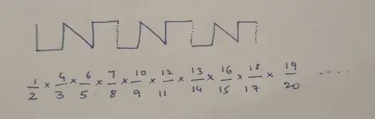

Here's my work. I took the 5th term of the sequence and reciprocated everything to get a 1 2 3 4 5 6 pattern in the manner shown by the arrows. It repeats itself at the dotted edge with the dotted edge being common to the two recurring units.
Here's the INCORRECT image attached.

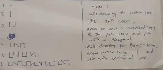

edit : I am very sorry for switching 11 and 12. This was a silly error on my part. This then changes the pattern and it becomes more confusing now.
here's the correct pattern for the first five terms:
I have also written the rules I have identified.
maybe someone can help me spot a pattern just like @C Squared did.
And I seem to like the pattern that @Stinking Bishop has spotted. The binary one. Maybe those lines work. But we want a general (probably recursive) formula.

  • The numerator is defined as $p_1 = 1, p_2 = 4, p_3 = 6$ and $p_{3(n+1)+k} = p_{3n+k}+6$ for each $k=0,1,2$. The denominator is defined similarly... – C Squared Dec 29 '22 at 08:10
    How do you know that it converges to $\sqrt{2}/2$? Also, are you sure that $11/12$ is the right way round? It seems to me that $\frac{2n+1}{2n+2}$ is reciprocated if and only if $n$ has odd parity when written in binary. If I am right, this breaks the pattern that you and @CSquared have spotted. –  Dec 29 '22 at 08:13
  • In fact, $n$ is in numerator if $n-1$ has even parity and in denominator if $n-1$ has odd parity. I don't know how (if at all!) this helps. –  Dec 29 '22 at 08:19
