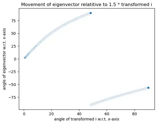

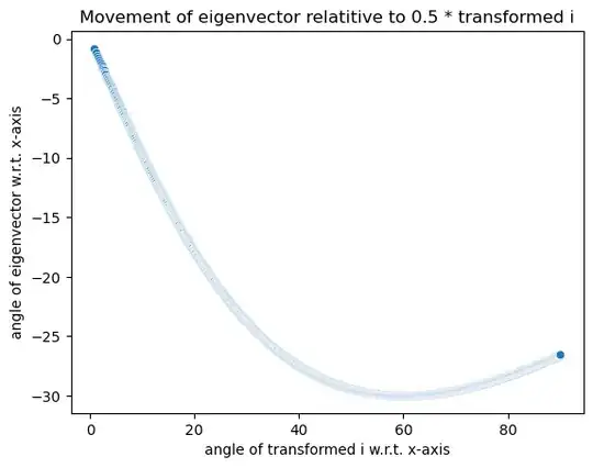

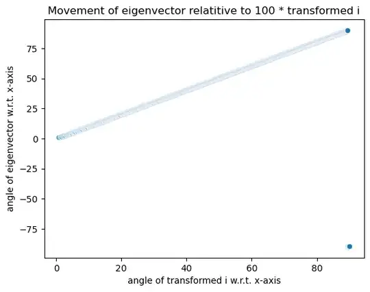

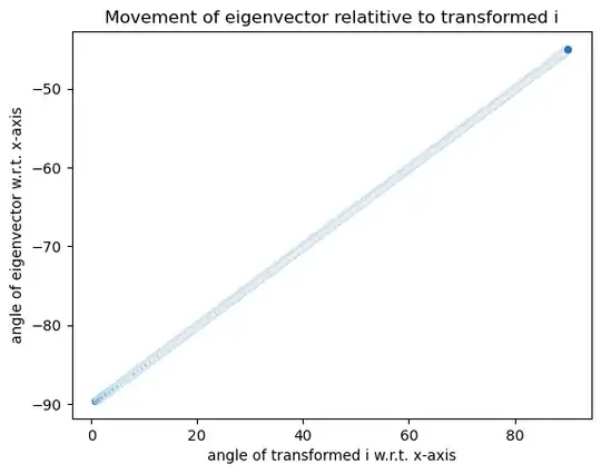

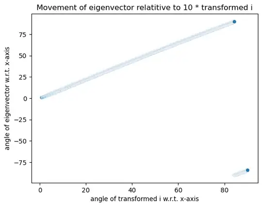

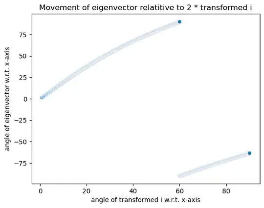

I left $j$ unchanged. I systematically altered $i$ to look for patterns in how eigenvectors change w.r.t changes in $i$. One eigenvector always remained parallel to $j$, so I only examined the effect on the other.
I first rotated $i$ from $0$ to $90$ degrees and found that the eigenvector sweeps an arc of a circle from $-90$ to $-45$ degrees.
Next, I scaled $i$ by varying factors from $0.5$ to $1000$ and rotated it as before after each scaling. I found some interesting patterns that I'm still pondering on.
Perhaps this will stimulate some thoughts.
Plot of systematically rotating i from 0 to 90 degrees. enter image description here

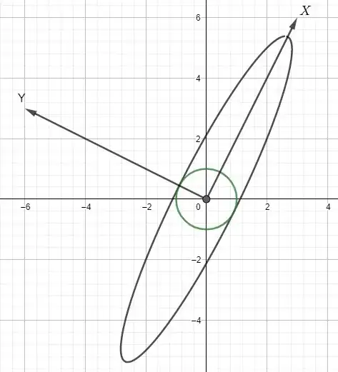

Here is a way to "eyeball" eigenvectors and eigenvalues as well in the particular case of symmetric matrices.
$$\pmatrix{a&b\\b&c}\pmatrix{x\\y}=\pmatrix{x'\\y'} \tag{1}$$
It sticks to your "maximal direction of shear" intuition.
Let us consider the image of the unit circle under the transformation which is an ellipse $\frak{E}$.
The main result (see explanation below) is that the major and minor axes of ellipse $\frak{E}$ are directed by the eigenvectors of the matrix.
Moreover, one can also visualize the eigenvalues as being the values of the semi-axes $a=\lambda_1, b=\lambda_2$ of ellipse $\frak{E}$ which means that with respect to the orthonormal axes $X-Y$ defined by the eigenvectors, the equation of the ellipse is :
$$\frac{X^2}{\lambda_1^2}+\frac{Y^2}{\lambda_2^2}=1$$
Remark: Here, we have taken matrix :
$$\pmatrix{2&2\\2&5} \ \ \text{with eigenvalues} \ \ \lambda_1=6, \ \lambda_2=1$$
$$\text{with associated eigenvectors} \ \ \pmatrix{1\\2}, \pmatrix{-2\\1}$$
Explanation: Using the inverse relationship of (1) : $$\pmatrix{d&e\\e&f}\pmatrix{x'\\y'}=\pmatrix{x\\y} $$
constraint $x^2+y^2=1$ gives:
$$(dx'+ey')^2+(ex'+fy')^2=1$$
which is the equation of a conic curve and it is easy to prove that it is the equation of an ellipse.

  • Isn't this rather a method of eyeballing singular vectors? – Nathan Wycoff Dec 28 '22 at 18:05
  • @John Madden You pinpoint an interesting point but the "rather" isn't exact. Plainly, singular vectors of $B$ enter into this frame because they are eigenvectors of symmetric matrix $B^TB$... – Jean Marie Dec 28 '22 at 18:11
  • Thank you for this thoughtful response +1. I will wait 2 days for an answer that generalizes to non-symmetric matrices before accepting. You clearly show how the "maximum direction of shear" points in direction of the $(1, 2)$ eigenvector; and for the symmetric matrix, the other eigenvector is orthogonal to it. To close the loop, are you saying that we can "eyeball" the eigenvectors by first drawing an ellipse based on 3 facts: center of the ellipse is the origin, the basis vectors are two known points $(2, 2)$ and $(2, 5)$ on the ellipse, and one of the axes will always be unit length? – Snehal Patel Dec 28 '22 at 18:22
  • Not these vectors but the following unit vectors constituting the orthonormal basis $\tfrac{1}{\sqrt{5}}(1,2)$ and $\tfrac{1}{\sqrt{5}}(-2,1)$. – Jean Marie Dec 28 '22 at 18:33
