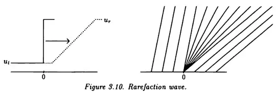

Split up the integral by considering the domain in $xt$ space. The figure below considers $f(u)=\frac{1}{2} u^2$.
The location of the rarefaction wave trailing edge is defined by $x=f'(u_l)t$, and the leading edge is defined by $x=f'(u_r)t$. The left side of eq. 1 can be written
