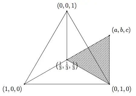

Another ad-hoc approach. Passing to the plane $x+y+z=1$ where the action takes place, we can see that $(0,1,0)$ rotates around $\left(\frac13, \frac13, \frac13\right)$ within the plane by the angle $\frac{\pi}3$ counter-clockwise.
By definition of $T$ we have
  • The angle $\angle (0,1,0),\left(\frac13, \frac13, \frac13\right),(a,b,c)$ is equal to $\frac{\pi}3$,
  • The distances from $\left(\frac13, \frac13, \frac13\right)$ to the points $(a,b,c)$ and $(0,1,0)$ are equal.
$\hspace{2.5cm}$image
It follows that the triangle with vertices $(0,1,0),\left(\frac13, \frac13, \frac13\right),(a,b,c)$ is equilateral so in particular \begin{align} \left(a-\frac13\right)^2 + \left(b-\frac13\right)^2 + \left(c-\frac13\right)^2 &= d\left(\left(\frac13, \frac13, \frac13\right), (a,b,c)\right)^2 \\ &= d\left((0,1,0),(a,b,c)\right) \\ &= a^2+(b-1)^2+c^2 \end{align} which is equivalent to $a-2b+c=1$, so this is your third equation as stated by @enzotib.
You can further simplify the system of equations if you show that the triangle with vertices $(0,0,1),\left(\frac13, \frac13, \frac13\right),(a,b,c)$ is also equilateral (and hence congruent to the aforementioned one) so in particular we have $$(a-1)^2+b^2 + c^2 = d((0,0,1),(a,b,c)) = d((0,1,0),(a,b,c)) = a^2+(b-1)^2+c^2$$ which immediately implies $a=b$, eliminating one of the solutions.
