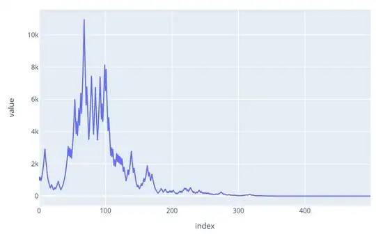

Consider the following game:
  • You start with $1000
  • Flip a fair coin
  • If it's heads gain 21%, if it's tails lose 20%
  • You can play as many times as you want
My question is:
  • How would you calculate the expected amount of money you have after N games?
  • How many times should you play?
If I consider playing a single round, the expected value would be:
$$ \begin{aligned} E[1] &= 1000 \cdot ( 0.5 \cdot 1.21 + 0.5 \cdot 0.8 ) \\ &=1005 \end{aligned} $$
It seems to me like the rational decision would be to play the game, because you expect to end up with more money. And then after your first coin toss, the same reasoning should apply for the decision about whether to play a second time, and so on... So then it seems like you should play as many times as possible and that your amount of money should approach infinity as N does. However when I simulate this in Python I am finding that the final amount of money always tends toward zero with enough flips. How can a game where each round has a positive expected return end up giving a negative return when played many times?
I read about the Kelly Criterion and think it might apply here. Calculating the geometric growth rate:
$$ \begin{aligned} r &= (1 + f \cdot b)^p \cdot (1 - f \cdot f )^{1-p} \\ &= (1 + 1 \cdot 0.21)^{0.5} \cdot (1 - 1 \cdot 0.2 )^{0.5} \\ &= 0.983870 \end{aligned} $$
This seems to indicate that I should not play, because the geometric growth rate is below 1. But how do I reconcile that with my reasoning above and the fact that the expected gain of playing any individual round is positive?

  • A guess - let $X_i$ be the multiplier that helps determine the bankroll at stage $i.$ Each $X_i$ is Bernoulli. If independent, the expectation after $n$ plays is easy. As for how many games to play - depends on your threshold. Do you stop with $100 in your pocket and leave? Or do you keep playing until you have ten times your initial stake? That's a stopping times question, I think. – Sean Roberson Dec 25 '22 at 02:36
    I suspect that this may be somewhat similar to the St. Petersburg paradox. Consider this way to analyse the game: given a (finite) sequence of heads and tails, if we have $H$ heads and $T$ tails, our balance after the flips is $1000 \cdot (1.21)^H (0.8)^T$. Thus, you can calculate that we need about $1.17$ times more heads than tails just to break even. So in the long run, playing this game seems like it would be pretty bad. I think that the issue is that the potential profits grow faster than the probability of winning shrinks, leading to an inaccurate expected value. – legionwhale Dec 25 '22 at 02:36
    I see the similarity but solutions like Expected Utility Theory don't apply to my scenario because my paradox is the reverse - how can something be good in the short run but bad in the long run, when repeated as independent trials? I don't see how the optimal N value could be anything other than 0 or infinity. Let's say it's N=25, does that mean you should play 25 games then quit? What if the next day you play another set of 25 games - would you lose money that time? Or if not, how is that different than playing 50 games in a row. – pyjamas Dec 25 '22 at 03:46
    I think everything gets easy in log space: $\log(0.8)=-0.22$, $\log(1.21)=0.19$. Expected value goes to $-\infty$ for $N\rightarrow\infty$, so you expect to end up with nothing, consistent with your simulation. – NeitherNor Dec 25 '22 at 06:06
    It's illuminating to compute the expected value of playing twice. – Karl Dec 25 '22 at 06:09

Here's an explanation for the deception: on average, we know that we will win in each round. That's what happens on a round-to-round basis.
However, in the long run, that's not what happens at a sample level. What actually happens is that, by the law of large numbers, you get heads roughly half the time, and tails roughly half the time at the level of simulations. That's what the law of large numbers tells you for the coin flips.
Say you have one dollar. Then, you gain $21$ percent to make it $1.21$, and then lose $20$ percent to get $0.968$. That means you are actually losing on average with one head and one tail. Similarly, if you lose $20$ percent first up to get $0.80$ and then gain $21$ percent , you will still get $0.968$. The loss is then accentuated for each pair of head and tail.
In other words, because we should compare $21$ percent gain and $20$ percent loss at the logarithmic level and not on the linear level, we were deceived by the appearance of the numbers. Turns out, the answer is exactly what you see by simulation : you will be a pauper in infinite time with probability $1$.
Another look at what's happening
Here is another look at things. We know that $\mathbb E[X_n]$ is increasing. However, what's happening is something like this : suppose that $R$ is a random variable, such that $(R=0) = 0.5 , P(R=2) = 0.5$.
What's the expected value? It's $\mathbb E[R] = 1$. However, take another bunch of random variables $P(S = 0) = 0.74, P(S=4) = 0.26\\ P(T = 0) = 0.956 , P(T=25) = 0.044 \\ P(U=0) = 0.999 , P(U=1150) = 0.01$.
The expected values are $\mathbb E[S] = 1.04,\mathbb E[T] = 1.1, \mathbb E[U] = 1.15$, which is an increasing sequence.
However, it's clear that these random variables are very different from each other, because the probability that $U$ exceeds its mean is so so small, while the probability that $S$ exceeds its mean is much larger. On the contrary, playing a game with returns like $U$ seems to be more profitable in expectation than playing for a game with returns like $S$!

Let's connect this to our game by looking at $X_2$. Suppose that $X_0= 1$. Each of the combinations $TT,TH,HT,HH$ happens with probability $\frac 12$. However, only on the occasion $HH$ is it true that $X_2>X_0$(that is , with probability $\frac 14$). However, $X_2$ is so, so much larger than $X_0$ on the occasion that $HH$ occurs, that $\mathbb E[X_2] > \mathbb E[X_0]$. A bit like what happens with $U$ : it takes one large value with small probability, and that's enough to skew the expectation.
Similarly, let's take $X_4$, where we have four coin flips. You will see that only on the occasions $HHHT,THHH,HTHH,HHHH$ (i.e. with probability $\frac 14$) is it true that $X_4 > X_0$. However, on these occasions, $X_4$ is large enough so that $\mathbb E[X_4]> E[X_0]$.
Taking $X_8$ etc., you will realize that the following is the phenomena in play :
  • $X_n$ is actually larger than $X_0$ with very, very small probability. (as $n$ gets larger)
  • However, on each such occasion, $X_n$ is so, so much more larger than $X_0$ that the expected gain is positive (and gets larger with $n$).
This sounds counterintuitive, but it's one of the cornerstones of probability. In fact, we will prove below that $X_n$ is SO, SO WEIRD THAT :
  • As $n \to \infty$, $\mathbb E[X_n] \to +\infty$ : expected infinite returns!
  • As $n \to \infty$, with probability $1$, $X_n \to 0$ (this is almost sure convergence) : with probability $1$, you'll be a pauper!
This sounds bizarre, but it's true. It is actually an supremely emphasized version of the problem that the St. Petersburg paradox suffers from : a lack of uniform integrability means that we cannot connect convergence to $0$ almost surely with convergence in mean. Your example is the extent to which things can go wrong!
(If need be, I'll explain the convergence-in-mean versus convergence-almost-surely thing in more detail. I'm leaving it out because I think it distracts a bit from what you ultimately want).
The formal proof
To prove the first assertion, we use induction to prove that if $X_0=a$ then $\mathbb E[X_n] = a(1.05)^n$. Indeed, for $n=0$ it is clear. For any $n$, ($X_n$ is bounded for fixed $n$, hence integrable) by the tower property and induction $$ \mathbb E[X_n] = \mathbb E[\mathbb E[X_n|X_{n-1}]] = \mathbb E[1.05X_{n-1}] = a(1.05)^n $$
For the second assertion, let $Y_n = \log X_n$ (note that $X_n$ can never be zero as long as $X_0 > 0$ by the rules of the game), then it seems that something interesting is going on.
Indeed, notice that $$ Y_{n+1} = \begin{cases} Y_n + \log 1.21 & \text{ with probability } \frac 12 \\ Y_n + \log 0.80 & \text{ with probability } \frac 12 \end{cases} $$ This screams "biased random walk!" and indeed it is : if $Z_i$ are iid random variables taking $\log 1.21$ and $\log 0.80$ each with probability $\frac 12$ and $a$ is some starting value then $Y_n = a + \sum_{i=1}^n Z_i$.
What is $\mathbb E[Z_i]$? It is $$ \mathbb E[Z_i] = \frac{\log 1.21 + \log 0.80}{2} \approx -0.016 < 0 $$ whence by linearity of expectation $$ \mathbb E[Y_n] \approx a - 0.016n $$
As a result of the law of large numbers, it follows that $Y_n \to -\infty$ almost surely as $n \to \infty$. By the continuous mapping theorem, it follows that $X_n \to 0$ as $n \to \infty$ almost surely.

The expected product of $n$ tosses is
$$\sum\limits_{k=0}^n 1.21^{n-k}0.80^k\binom{n}{k}\left(\frac{1}{2}\right)^n=(1.21+0.80)^n\left(\frac{1}{2}\right)^n=1.005^n$$
With $500$ tosses, the product is almost always close to $0$. But sometimes (very rarely), the product must be large, so that the average of the product is $1.005^{500}\approx 12.1$.
