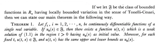

Finally, I found the answer here:
Thanks for the time you spent on my question!
