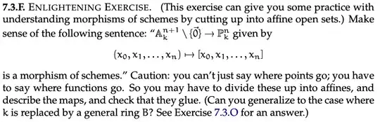

In Vakil's FOAG, the projective space $\Bbb{P}^n_A$ is defined to be $\operatorname{Proj} A[x_0, x_1, \ldots, x_n]$. (there is another definition in the book too, just glueing $n+1$ affine space). Then in serveral exercises, the author uses the symbol $[x_0, x_1, \ldots, x_n]$ without giving the meaning of it. For example(added a screenshot too for voiding misquote):
7.3.F Make sense of the following sentence: $\Bbb{A}_k^{n+1} \backslash \{\vec{0}\} \to\Bbb{P}^n_k$ given by $(x_0, x_1, \ldots, x_n) \mapsto [x_0, x_1, \ldots, x_n]$ is a morphism of schemes.
I did get a morphism $\Bbb{A}_k^{n+1} \backslash \{\vec{0}\} \to\Bbb{P}^n_k$ by glueing the morphism $$D(x_i) = \operatorname{Spec} A[x_0, x_1, \cdots, x_n]_{x_i} \to \operatorname{Spec} (A[x_0, x_1, \ldots, x_n]_{x_i})_0 = D_+(x_i)$$. But I cannot see how is it given by $(x_0, x_1, \ldots, x_n) \mapsto [x_0, x_1, \ldots, x_n]$.
Related paragraphs are in FOAG subsection 4.5.7 (page 150) and exercise 7.3.F (page 202) (and exercise 7.3.O uses the notation $[f_0, f_1, \ldots, f_n]$)

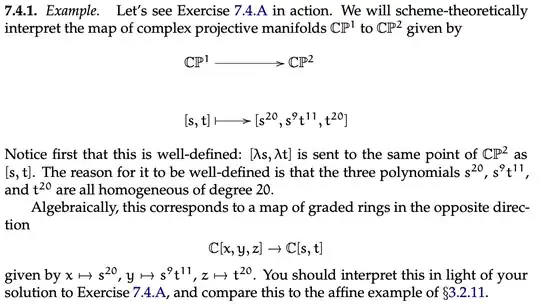

There are more examples using notations of this style, e.g., 7.4.1 Example, the morphism $\Bbb{C}\Bbb{P}^1 \to \Bbb{C}\Bbb{P}^2$ given by $[s, t] \to [s^{20}, s^{9}t^{11}, t^{20}]$. I interpret it as the morphism given by $\Bbb{C}[x, y, z] \to \Bbb{C}[s, t]$ given by $x=s^{20}, y=s^9t^{11}, z=t^{20}$. Nevertheless, the usage of notation $[x_0, x_1, \ldots, x_n]$ in exercise 7.3.F seems unable to be interpret in this way.

After Robert and hm2020's excellent answers, I want to update the question and make my question more specific to the sentence "given by $(x_0, x_1, \cdots, x_n) \mapsto [x_0, x_1, \cdots, x_n]$". I think I know how to construct the morphism, here is a proof(skip it if too long, my concrete question is after the proof):
Denote $D(x_i)$ be the distinguished open subset of $\mathbb{A}_{k}^{n+1}$ that $x_i$ does not vanished. Then one has that $\cup D(x_i) = \mathbb{A}_{k}^{n+1}\backslash\{\overrightarrow{0}\}$: if some point $p \notin \cup D(x_i)$, then for all $x_i$ one has $p \notin D(x_i)$, i.e., $x_i \in p$. Then $(x_0, x_1, \ldots, x_n) \subset p$. Since $(x_0, x_1, \ldots, x_n)$ is a maximal ideal, one have $(x_0, x_1, \ldots, x_n) = p$. Then $p = \overrightarrow{0}$ by the notation and $p \notin \mathbb{A}_{k}^{n+1}\backslash\{\overrightarrow{0}\}.$ If $p \in \cup D(x_i)$, then there is some $x_i$ such that $p \in D(x_i)$. Hence $x_i \notin p$. Hence $p \neq \overrightarrow{0}$ and $p \in \mathbb{A}_{k}^{n+1}\backslash\{\overrightarrow{0}\}$.
On the other hand, denote $D_+(x_i)$ be the homogeneous distinguished open subset of $\Bbb{P}^n_k := \operatorname{Proj} k[x_0, x_1, \ldots, x_n]$ that $x_i$ does not vanished. One has $\Bbb{P}^n_k = \cup D_+(x_i)$.
By $D(x_i) \cong \operatorname{Spec} k[x_0, x_1, \ldots, x_n]_{x_i}$ and $D_+(x_i) \cong \operatorname{Spec}(( k[x_0, x_1, \ldots, x_n])_{x_i})_0$ and since any map on rings induce a map on the schemes of their spectrums on the opposite direction, from the inclusion map $(( k[x_0, x_1, \ldots, x_n])_{x_i})_0 \hookrightarrow k[x_0, x_1, \ldots, x_n]_{x_i}$ one has
$$D(x_i) \cong \operatorname{Spec} k[x_0, x_1, \ldots, x_n]_{x_i} \to D_+(x_i) \cong \operatorname{Spec}(( k[x_0, x_1, \ldots, x_n])_{x_i})_0$$
. Composing it with $D_+(x_i) \hookrightarrow \Bbb{P}^n_k$. One has morphisms $\phi_i: D(x_i) \to \Bbb{P}^n_k$.
These morphisms in fact can be glued into a morphism $\mathbb{A}_{k}^{n+1}\backslash\{\overrightarrow{0}\} \rightarrow \mathbb{P}_{k}^{n}$, i.e, they agree on the overlaps: Since $D(x_i) \cap D(x_j) = D(x_i x_j) \cong \operatorname{Spec} k[x_0, x_1, \ldots, x_n]_{x_i x_j}$ and $D_+(x_i) \cap D_+(x_j) = D_+(x_i x_j) \cong \operatorname{Spec} (( k[x_0, x_1, \ldots, x_n])_{x_i x_j})_0$, one has $\phi_i |_{D(x_i) \cap D(x_j)} = \phi_j |_{D(x_i) \cap D(x_j)}: \operatorname{Spec} k[x_0, x_1, \ldots, x_n]_{x_i x_j} \to \operatorname{Spec} (( k[x_0, x_1, \ldots, x_n])_{x_i x_j})_0 \hookrightarrow \Bbb{P}^n_k$.
$\square$
But from the proof, one see that the morphism $\mathbb{A}_{k}^{n+1}\backslash\{\overrightarrow{0}\} \rightarrow \mathbb{P}_{k}^{n}$ is just "given"(one construct it from glueing of pieces, and the morphism on pieces are just given like "from one's mind", It's like "aha. as we already know this and this, we construct it from that and that"). It's not as Vakil said in the text, the morphism is "given by $(x_0, x_1, \cdots, x_n) \mapsto [x_0, x_1, \cdots, x_n]$". I can make sense construction a morphism $\mathbb{A}_{k}^{n+1}\backslash\{\overrightarrow{0}\} \rightarrow \mathbb{P}_{k}^{n}$, but I cannot make sense how it "given by $(x_0, x_1, \cdots, x_n) \mapsto [x_0, x_1, \cdots, x_n]$".
So my question is about how "given by $(x_0, x_1, \cdots, x_n) \mapsto [x_0, x_1, \cdots, x_n]$" really make sense scheme-theoreticly? I know that:

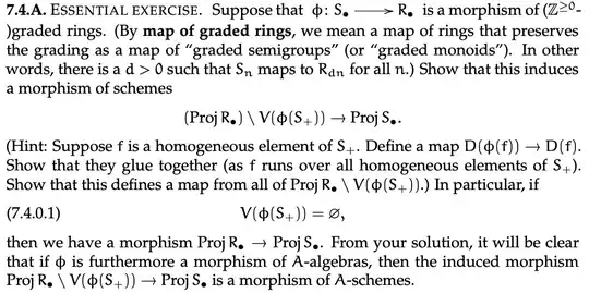

  3. For morphism on projective schemes, I understand it too I think, it's via Vakil's section 7.4(here I have to attach two screenshots to make the context complete): enter image description here enter image description here
But back to the case "given by $(x_0, x_1, \cdots, x_n) \mapsto [x_0, x_1, \cdots, x_n]$", the map $\mathbb{A}_{k}^{n+1}\backslash\{\overrightarrow{0}\} \rightarrow \mathbb{P}_{k}^{n}$ is neither affine scheme to affine scheme, nor project scheme to project scheme. How can it make sense saying "given by $(x_0, x_1, \cdots, x_n) \mapsto [x_0, x_1, \cdots, x_n]$"?
