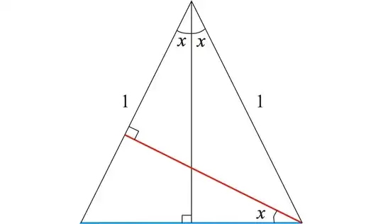

$$\color{red}{\sin 2x}=\color{blue}{2\sin x}\cos x$$
- 54,260
5Wow this makes much more sense!! Thanks man! – Commander Shepard Aug 05 '13 at 14:48
3Sorry i don't get it... – David G Aug 05 '13 at 15:35
10@David There are two ways to calculate the red thing: 1) from the right triangle with hypotenuse $1$ (this gives $\sin 2x$) and 2) from the complementary right triangle with blue hypotenuse, equal to $2\sin x$. – Start wearing purple Aug 05 '13 at 15:37

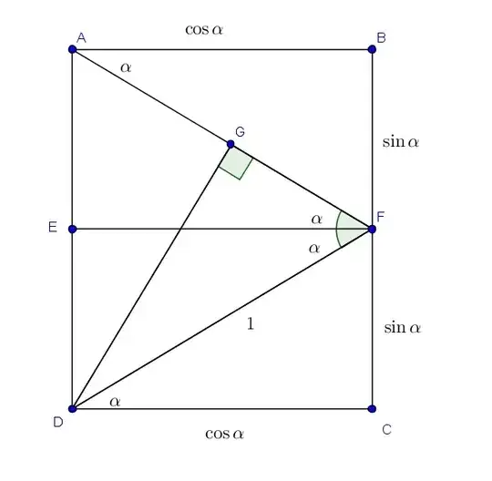

1@Blue those pictures are fantastic, thank you. These deserve more exposure. – littleO Aug 07 '13 at 23:28
Geometrically, the area of an isosceles triangle with apex $2\alpha$ and leg length $1$ can be computed with one of the legs as base, then the height is $\sin 2\alpha$. So th earea is $\frac12\sin 2\alpha$.
Alternatively, the base has length $2\sin \alpha$ and the corresponding height is $\cos \alpha$, thus the area is $\frac12\cdot2\sin\alpha\cos\alpha$.
Equating both, you get $\sin2\alpha=2\sin\alpha\cos\alpha$.
