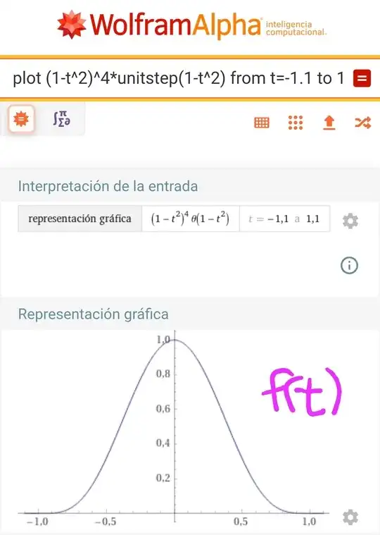

Let think in the function:
$$f(t) =\left(1-t^2\right)^4\cdot\theta(1-t^2)\equiv \left(\frac{1-t^2+|1-t^2|}{2}\right)^4\tag{Eq. 1}\label{Eq. 1}$$
which is a real-valued square-integrable even function, with $\theta(t)$ the unitary step function.
function in the time variable

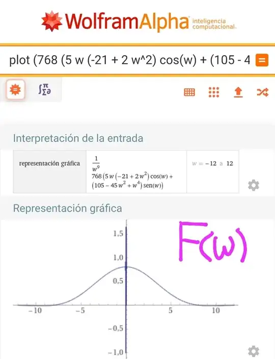

At can be seen in Wolfram-Alpha, the Fourier Transform is given by: $$\begin{array}{r c l} F(w) & = & \int\limits_{-\infty}^{\infty} f(t)\,e^{-iwt}\,dt \\ & = & \int\limits_{-1}^{1} (1-t^2)^4\,e^{-iwt}\,dt \\ & = & \displaystyle{\frac{768}{w^9}\cdot \Big(5\ w\ (2\ w^2-21)\cos(w)+(w^4-45\ w^2+105) \sin(w)\Big)} \tag{Eq. 2}\label{Eq. 2} \\ \end{array}$$
which is reviewed in detail in this question since shows an horrid spike when plotted, but it end to be an artifact due current software, since it is continuous at the origin as is show in this answer by @CalvinKhor.
Fourier transform of f(t)
As expected, since $f(t)$ is real-valued and an even function, its Fourier transform $F(w)$ is also real-valued and even function (see Wikipedia Table line $111$).

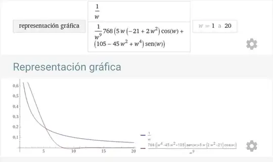

So, since $f(t)$ lives in the real axis as also do $F(w)$, which I believe it is indeed analytic in $w$, and also if I plot the Fourier Transform of Eq. 2 jointly with the function $1/|w|$ it shows indeed a decay faster than the $1/|w|$, so in principle I think its fulfilling the conditions, as can be seen here
decay faster than 1/w
So $f(t)$ should be fulfilling the conditions of the Kramers-Kronig relations, so I don't know why the previous equations aren't fulfilled. Hope you explain in detail if I have misunderstood some of the conditions.
