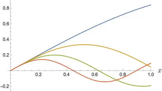

For a bit of extra we can look at the situation at $x=0$ specifically by plotting a few of the functions from the sequence. enter image description here
In the image you see the graphs of $f_1,f_3,f_5$ and $f_7$. You see that near $x=0$ they have nearly identical slopes. That's exactly because $f_n'(0)=1$ for all $n$. But you also see that the graphs follow this tangent line for shorter and shorter intervals before they begin to oscillate.

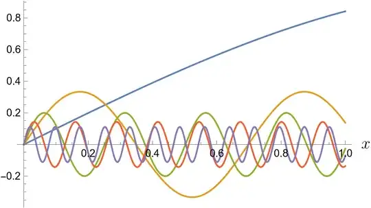

Or even $$f_n(x)=\frac1n\sin(n^2x).$$ We still have $f_n\to0$ uniformly (the factor $1/n$ is decisive). This time $$f'_n(x)=n\cos(n^2x),$$ and $f'_n(0)\to\infty$ as $n\to\infty$. See below for the sample plots $f_1,f_3,f_5,f_7,f_9$ from this sequence. Observe that as $n\to\infty$ the derivatives at zero $\to\infty$, the sine waves become steeper and steeper.
The point (if any) is that in general uniform convergence of a sequence itself does not say anything about the convergence of the derivatives. The power series form a notable exception, and in the case of power series we are always guaranteed that the sequence of derivatives also converges uniformly (on any compact interval contained in the interval of convergence). As we saw, a sequence of wildly oscillating ($\Rightarrow$ larger and larger derivatives) functions can converge to zero uniformly.
A sine wave can be as steep as we desire without the amplitude going up, simply increase the frequency. The amplitudes tending to zero gives uniform convergence of the functions, and this is unrelated to how steep the waves become because the frequency can (over)compensate.
