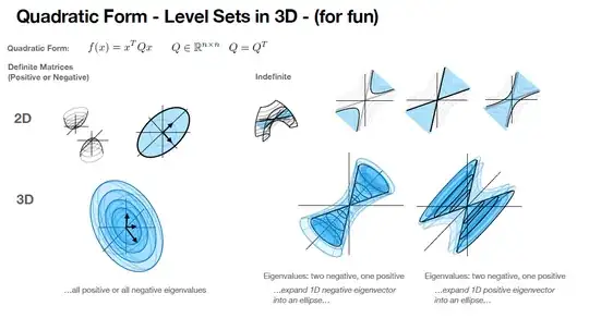

The image below is from a department faculty's publicly published notes on the subject. It makes me wonder more about the connections between these Quadratic Forms, the eigenvalues of $\mathbf{Q}$ and the action of the matrix $\mathbf{Q}$ itself. And, more generally, how we can think about these quadratic forms when the nesting objects are themselves matrices, rather than simple vectors.
