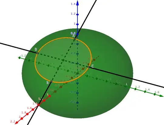

Without loss of generality we may assume that the major semi-axis of your ellipsoid is $1$ and minor semi-axis is $a<1$ (hence $F=a$), so we can write the equation of the ellipsoid as $$ \tag{1} x^2+y^2+{z^2\over a^2}=1. $$ We are free to choose $x$ and $y$ axes such that the intersecting plane is parallel to $y$ axis. Planes parallel to $z$ axis give rise to ellipses with axis ratio equal to $a$, hence we may ignore them. The equation of the intersecting plane can then be written as $$ \tag{2} z=mx+k. $$ The intersection between ellipsoid and plane is an ellipse, whose minor axis is a line on $xz$ plane having the same equation $(2)$ as the plane. The intersections $A$ and $B$ between this line and the ellipsoid can then be found plugging $y=0$ and $z=mx+k$ into $(1)$ and solving the equation for $x$. Their $x$ coordinates are then given by $$ x={-mk\pm\sqrt{m^2k^2-(a^2+m^2)(k^2-a^2)}\over a^2+m^2} $$ and their $z$ coordinates can be found from $(2)$. We can then compute distance $AB$, which is the length of the minor axis of the ellipse: $$ AB={2a\sqrt{1+m^2}\sqrt{a^2+m^2-k^2}\over a^2+m^2}. $$ The center of the ellipse is the midpoint $M$ of $AB$: $$ x_M=-{mk\over a^2+m^2},\quad z_M={a^2k\over a^2+m^2}. $$ The major axis of the ellipse is the line through $M$ parallel to $y$ axis. Its intersections with the ellipse can be found plugging $x$ and $z$ coordinates of $M$ into $(1)$ and solving for $y$: $$ y^2={a^2+m^2-k^2\over a^2+m^2}. $$ From that, we can find the length of major axis $CD$: $$ CD=2{\sqrt{a^2+m^2-k^2}\over \sqrt{a^2+m^2}}. $$ Now we can compute the desired ratio: $$ {AB\over CD}=a{\sqrt{1+m^2}\over \sqrt{a^2+m^2}}. $$ As $a<1$ this ratio is always greater than $a$, as it was to be proved.
