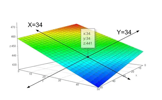

Assuming that you are not interested in deep theory, you can get a 'solution' either by a simple computer program with nested loops or a plot of the function in the form $z=..."$, such as the one below. Depending on the plotting tool, you can get more information about any point in the plane by a mouse click. Each positive-valued pair of $x$ and $y$ on the plane is a 'solution'. Note that the shown picture does not represent all solutions, since it is plotted in a specific range. Graphing could answer some questions one can't easily get a closed-form for sometimes.
The plot below is made for $z=(2850-2x-4y)/6$
If you have more information, for example $x+y<= 30$ for $Z=441$, in this case you could further limit the number of points that satisfies the relationship.

The tool used is:3-D Surface Plotter
