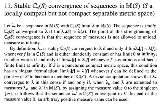

Update: I think I was wrong in claiming that "the author's definition of a function with limit $0$ at infinity coincides with the usual one". Let $\alpha=0$ and $\varepsilon>0$. Then $(-\varepsilon, \varepsilon)$ is a neighborhood of $\alpha$.
  • In author's sense: there is a compact subset $K$ of $S$ such that $f^{-1}((-\varepsilon, \varepsilon)) \subset K^c$. This is equivalent to $|f(x)| < \varepsilon \implies x \in K^c$.
  • In the usual sense: there is a compact subset $K$ of $S$ such that $|f(x)| < \varepsilon$ for all $x \in K^c$. This is equivalent to $|f(x)| \ge \varepsilon \implies x \in K$.
For a reference, I attach below a screenshot from the book.

  • @PaulSinclair Maybe I'm wrong, but [$|f(x)| < \varepsilon \implies x \in K^c$] is equivalent to [$x \in K \implies |f(x)| \ge \varepsilon$]. – Analyst Nov 04 '22 at 18:22
    Sorry. You are right about that. – Paul Sinclair Nov 04 '22 at 18:26
    I have to believe the author intended the normal definition. Since the empty set is technically compact, the author's definition as stated would imply that for every $\alpha$, every function $f$ would have limit $\alpha$ at infinity. – Paul Sinclair Nov 04 '22 at 18:32
