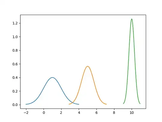

I want to create the distance distribution of uniformly distributed points in different dimensions, to ultimately visualize the curse of dimensionality. My understanding is that the distribution goes from a flatter curve in low dimensions to a spike curve in higher dimensions. They look like this: sketch from gaussian

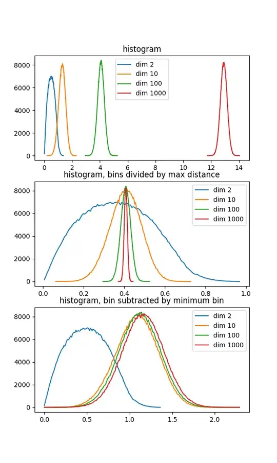

Mean increases, variance decreases. Don't mind numbers, this is just a sketch (with gaussian distribution) I have seen corresponding figures in papers. (Would be able to show and cite, but not sure about copyrights.) I want to recreate those figures. But when I create random points calculate the distances and put them in to a histgram it looks like this: my distance distribution
The first one is the plain histogram of distances. The second one, the bin are scaled to the max distance of the repective dimensions. In the third one I overlayed them by subtracting the value of the lowest non-empty bin. The first one obviously has the means, but neither increasing height nor decreasing variance. In the second you can see the concentration of the distances, but not height or means. This is not what I saw in those papers. The third indicates that the curves have all the same shape. Again, not what I expected. This is the code I used to create the second figure.

if name == 'main': records = 1000 binwidth = 0.01 precision = 10 fig, ((ax1), (ax2), (ax3)) = plt.subplots(3, 1) fig.set_size_inches(6, 10) for dimensions in [2, 10, 100, 1000]: data = np.random.uniform(low=0, high=1, size=(records, dimensions)) data = np.around(data, decimals=precision) distlist = distance.pdist(data)
    variance = np.var(distlist)
    print('dim {dim}: var={var}'.format(dim=dimensions, var=variance))
    maxdist = math.pow(dimensions, 1 / 2)
    bins = [round(x * binwidth, 2) for x in range(round(maxdist / binwidth) + 2)]
    histo = np.histogram(distlist, bins)
    harr = np.stack((histo[1][1:], histo[0]), axis=-1)
    mask = harr[:, 1] > 0
    masked = harr[mask]
    ax1.plot(masked[:, 0], masked[:, 1], label='dim {dim}'.format(dim=dimensions))
    ax2.plot(masked[:, 0] / maxdist, masked[:, 1], label='dim {dim}'.format(dim=dimensions))
    min = np.min(masked[:, 0])
    ax3.plot(masked[:, 0] - min, masked[:, 1], label='dim {dim}'.format(dim=dimensions))
ax1.set_title('histogram')
ax1.legend()
ax2.set_title('histogram, bins divided by max distance')
ax2.legend()
ax3.set_title('histogram, bin subtracted by minimum bin')
ax3.legend()
plt.show()

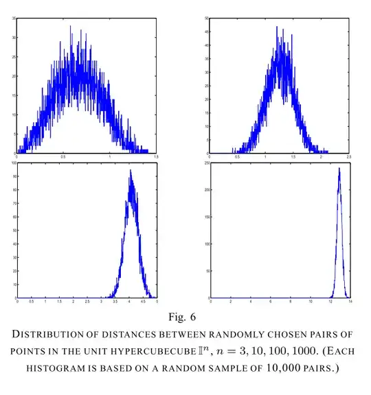

EDIT Ok, thanks to @Henry it seems what I did was correct but not what I should have done to produce the results I wanted. What I want is the to produce the following figures myself.
The image is taken from
Pestov, Vladimir (2007): Intrinsic dimension of a dataset: what properties does one expect? In : 2007 IEEE International Joint Conference on Neural Networks Proceedings. International Joint Conference on Neural Networks.
Fig. 14 of
Chávez, Edgar; Navarro, Gonzalo; Baeza-Yates, Ricardo; Marroqu\’ın, José Luis (2001): Searching in metric spaces. In ACM Computing Surveys 33 (3), pp. 273–321. DOI: 10.1145/502807.502808.
is a similar one.
The text does not describe how to create them. How can I do this?

  • Your second chart called "histogram" is essentially equivalent to those suggested in https://math.stackexchange.com/a/1985698/6460 where the mean is slightly below $\sqrt{\frac{n}{6}}$ and the standard deviation about $\sqrt{\frac{7}{120}} \approx 0.24$ which is the constant limit as $n$ increases and is suggested by your graph. Subtracting the mean gives convergence to a normal distribution as $n$ increases, with a justification at https://stats.stackexchange.com/questions/241504/central-limit-theorem-for-square-roots-of-sums-of-i-i-d-random-variables – Henry Nov 03 '22 at 02:06
  • So with the hypercube $[0,1]^{1000}$ it is indeed correct that over $99.99%$ of pairs of points chosen independently and uniformly are a distance between $12$ and $14$ apart despite the possible range of distances being from $0$ to $\sqrt{1000}\approx 31.62$. – Henry Nov 03 '22 at 02:12

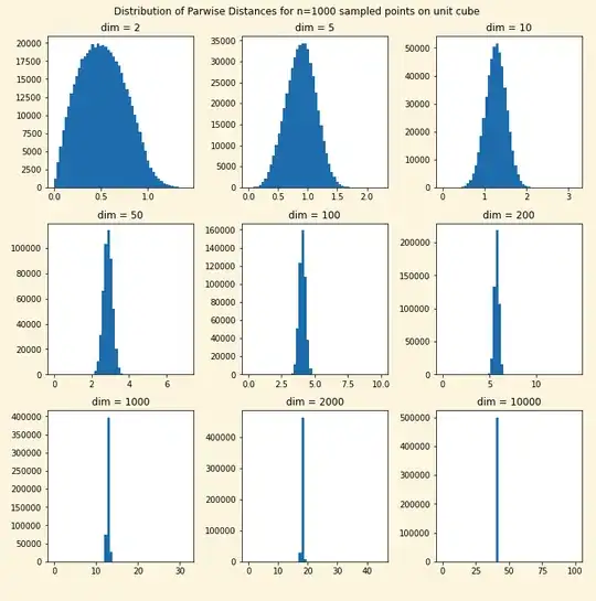

Does the following work? The code samples $n=1000$ points on $[0,1]^d$ for $d=2,5,10, 50,100,200, 1000, 2000, 10000$. For each $d$, we will compute the pairwise Euclidean distance between the $n$ points and plot a histogram. As the dimension increases, we will see that the distribution of the distances becomes more and more concentrated. This is bad because it means that all the points have similar distance to each other, and so we cannot really figure out different labels for these points (say in a classification problem).
Note: the 2-norm has min value zero, and max value $\sqrt{2}$, so for dimension 2, the maximum 2-norm is $\sqrt{2}$, for dim=d, the maximum is $\sqrt{d}$, which is why the x-axis range changes from plot to plot. You can change this x axis argument to suit your needs. Also you can play around with bin widths by changing the bins parameter in the histogram function
import numpy as np
n = 1000
dims = [2, 5, 10, 50, 100, 200, 1000, 2000, 10000]
fig, axs = plt.subplots(3,3, figsize=(10,10))
for i, ax in enumerate(axs.flat):
    d = dims[i]
# randomly sample N points from [0,1]^dim
X = np.random.uniform(low=0., high=1., size=(n, d))
# compute pairwise distances between the points
pdists = np.array([np.linalg.norm(X[i]-X[j], ord=2) for i in range(n) for j in range (i+1, n)])
# plot histogram
ax.hist(pdists, range=[0, np.sqrt(d)], bins=50)
ax.set_title(f"dim = {d}")
plt.suptitle(f"Distribution of Parwise Distances for n={n} sampled points on unit cube") plt.tight_layout()
