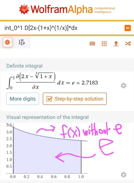

By the way, the founded example is just $$\int_0^1 \frac{\partial}{\partial x}\left[2x-(1+x)^{\frac{1}{x}} \right]\,dx = e$$
example in wolfram alpha
