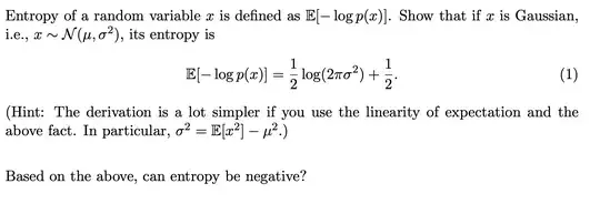

I've been asked the following question, and I can't solve it definitively. I've solved the first part, but I'm not sure about whether entropy can be negative or not. It wouldn't make much sense for it to be, but just by using inequalities and basic maths, I get the following inequality: $$\sigma^2 < \frac{1}{2e^{}\pi}$$ If that is satisfied, then the entropy is negative, and it certainly makes sense for the variance to be able to take that value. So am I going wrong somewhere, or can the entropy be negative?
