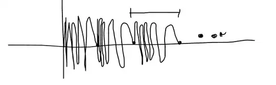

If there is a sequence of zeros of a function and this sequence tends to 0, then is $f$ not periodic, true or false?
I think it is false, for example, if we consider the function $\cos(\frac1{\sqrt x})$ for $x>0$, in intervals of amplitude equal to the largest zero of the function, we will obtain a periodic function, but however , the distance between its zeros also converges to $0$.
But I would like to know what hypotheses would have to be added to be true, if it is always false or not,...

The statement is false, as you correctly said. Apart from the “trivial” case that $f$ is identically zero, there are many continuous periodic functions on $\Bbb R$ with zeros accumulating at zero.
Your example does not work however, because $\cos(\frac1{\sqrt x})$ is not periodic.
A simple example (inspired by geetha290krm's comment) is $f(x) = \min(\sin(x), 0)$, which is $2\pi$-periodic and identically zero on $[0, \pi]$.
But you can start with any continuous function on an interval $[0, T]$, having zeros accumulating at $x=0$, and $f(0) = f(T) = 0$. Then extend $f$ to a periodic function on $\Bbb R $ by setting $f(x+nT) = f(x)$ for all integers $n$.

Take $f(x)=\sin(x)\sin\left(\frac{1}{\sin(x)}\right)$ (and define it as $0$ where that is undefined) for a continuous counterexample.
Here's how it looks
