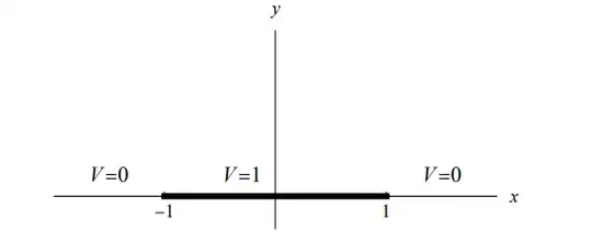

Full disclosure: This is technically a "homework" question but not really. What I mean is that my professor gave us free reign to use Mathematica to simply get the answer to the integral but I am trying to go the extra mile and understand the full derivation, but I'm stuck.
The problem is solving the Laplace equation for a finite strip. The solution which I've already derived is:
$$V(x,y)=\frac{1}{2\pi}\int_{-\infty}^{\infty}\frac{2\sin{k}}{k}e^{ikx}e^{-|k|y}dk\tag{1}$$
He asks us to try to solve this integral by hand (and if we can't, to feel free to simply use Mathematica to get the answer) which I've been working on for a couple of hours. I've gotten as far as changing the integral to:
$$V(x,y)=2\int_{0}^{\infty}dk\frac{\sin{k}}{k}e^{ikz}-2\int_{0}^{-\infty}dk\frac{\sin{k}}{k}e^{ikz^*}\tag{2}$$
Where $z\equiv(x+iy)$. This is something like the Fourier transform that takes $\text{sinc}(k)\rightarrow\tilde{\text{sinc}}(z)$ but I've never evaluated a Fourier transform in the complex plane. I know I'm on the right track as the correct answer is:
$$V(x,y)=-\frac{2}{\pi}\Im(\text{arctanh}(z^{-1}))\tag{3}$$
But I'm nevertheless stuck and would appreciate a hint or a nudge in the correct direction so that I see how to proceed.
