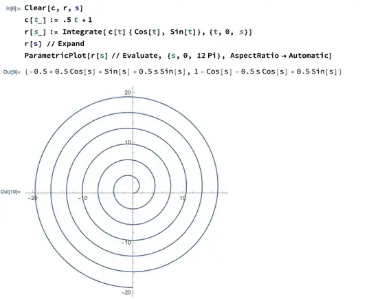

Below is a plot of an illustrative example in which $c(\theta) =.5 \theta+1$ is especially simple. In this case the total arc length along the spiral can be found by integrating $ds= c(\theta) d\theta$ to obtain $s= \frac{\theta^2}{4}+\theta$. This is a quadratic relationship between the angle $\theta$ and the length $s$ of the strap. (As mentioned above however, this $\theta$ should not be confused with the polar coordinate angle $\phi$ of the position vector $\vec R(\theta)$, although in practice for large values it is true that $\theta \approx \phi$.)
Simplest case: <span class=$c(t)=.5 t+1$ " />
