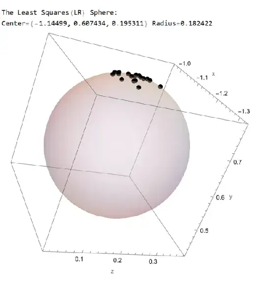

Least Squared Spherical Regression
Port of a MATLAB solution in Mathematica.

sphereFit[data_] := Module[{A, B, Center, Radius, meanX, meanY, meanZ},(Compute the means)meanX = Mean[data[[All, 1]]]; meanY = Mean[data[[All, 2]]]; meanZ = Mean[data[[All, 3]]]; (Compute matrix A) A = {{Mean[(data[[All, 1]] - meanX)data[[All, 1]]], 2Mean[data[[All, 1]](data[[All, 2]] - meanY)], 2Mean[data[[All, 1]](data[[All, 3]] - meanZ)]}, {0, Mean[(data[[All, 2]] - meanY)data[[All, 2]]], 2Mean[data[[All, 2]](data[[All, 3]] - meanZ)]}, {0, 0, Mean[(data[[All, 3]] - meanZ)data[[All, 3]]]}}; A = A + Transpose[A]; (Compute vector B) B = {Mean[(data[[All, 1]]^2 + data[[All, 2]]^2 + data[[All, 3]]^2)(data[[All, 1]] - meanX)], Mean[(data[[All, 1]]^2 + data[[All, 2]]^2 + data[[All, 3]]^2)(data[[All, 2]] - meanY)], Mean[(data[[All, 1]]^2 + data[[All, 2]]^2 + data[[All, 3]]^2)(data[[All, 3]] - meanZ)]}; (Compute the center)Center = LinearSolve[A, B]; (Compute the radius) Radius = Sqrt[ Mean[Total[(data - ConstantArray[Center, Length[data]])^2, {2}]]]; (Return center and radius){Center, Radius}]
{center, radius} = sphereFit[data]; Print["The Least Squares(LR) Sphere: Center=", center, " Radius=", radius];
(Visualize data and best fit sphere) Show[Graphics3D[{PointSize[0.02], Point[data], Opacity[0.3], Sphere[center, radius]}], Axes -> True, AxesLabel -> {"x", "y", "z"}]
