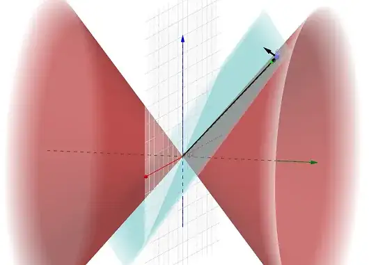

Vector $\vec{v}$ is not just any vector, as it is defined to be in a plane that has angle $i$ with the XZ plane. Therefore knowing $\vec{v}$ effectively fixes $i.$ Indeed, $i=\pi/2-\cos^{-1}(\hat{v}\cdot \hat{n}_1)$ where $n_1=(0,1,0)=\text{ the y-axis.}$ Even though $i,$ the angle of our sought plane with plane XZ is known, that still leaves an infinity of planes which satisfy the condition. For my convenience, I assure that all vectors are converted to unit vectors before calculation.
All of the planes that make angle $i$ with plane XZ will lie along the edge of a cone. Said cone will have the y-axis as its axis with its vertex at the origin. Its equation will be $$x^2 + z^2 = (y\cdot \tan(\pi/2 - i))^2.$$ For reference to this see 1224620.
Plane in blue with vector v in the plane In the picture, the grid is the XZ plane and the blue plane is "the plane that we seek".
The normal to this plane necessarily must also be a normal to the cone, which will just be the coefficients of the Cartsian equation multiplied times any point C which is on the surface of the cone. But, we do need to carefully select point C.
Since we have built the cone to include vector $\vec{v}$, we can let point C be the end point of the vector. $C=v.$ Here are the coefficients.
$$\begin{align}\text{Coefficient of x^2: }&1\\ \text{Coefficient of y^2: }&-\tan^2\left(\frac{2i-\pi}{2}\right)\\ \text{Coefficient of z^2: }&1 \end{align}$$ and the normal to the plane $$\hat{n}=\frac{\left( \begin{array}{ccc} \hat{v}_x\\ -\tan^2\left(\frac{2i-\pi}{2}\right)\cdot \hat{v}_y\\ \hat{v}_z \end{array} \right)} {\left\Vert \left( \begin{array}{ccc} \hat{v}_x\\ -\tan^2\left(\frac{2i-\pi}{2}\right)\cdot \hat{v}_y\\ \hat{v}_z \end{array} \right)\right\Vert} $$
The plane equation: $$\hat{n}\cdot \left(\begin{array}{ccc}x\\y\\z\end{array} \right)=\hat{n}\cdot C\qquad \text{remember point C=v}$$ We still have to deal with $\theta,$ to get vector $\vec{r}$ in the same plane, but that seems straigtforward. Remember that $\theta$ is given while $\vec{r}$ is not given. We need an orthogonal basis for the plane. We already have one unit vector in the plane, namely $\hat{v}.$ We also have the unit normal vector $\hat{n}.$ Cross them to get a 2nd basis vector in the plane. $$\hat{u}=\frac{n\times v}{|n\times v|}$$ Now just use a rotation in the plane to find some vector that is $\theta$ degrees away from $v,$ but in the plane. For a reference to this see 1830695 $$r = cos(\theta)\hat{v}+sin(\theta)\hat{u}$$
