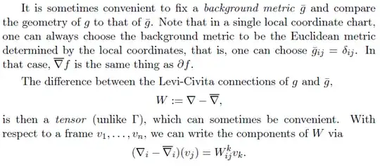

The following text comes from the book Geometric Relativity written by Dan A. Lee.
Blockquote
The expression $(\nabla_i-\overline{\nabla}_i)(v_j)$ may be a little perplexing, but according to what I've learned so far, that means $$\nabla_{v_i}v_j-\overline{\nabla}_{v_i}v_j.$$ Then we would have $$W_{ij}^k=\Gamma_{ij}^k-\overline{\Gamma}_{ij}^k=\frac{1}{2}g^{k\ell}(g_{\ell i,j}+g_{\ell j,i}-g_{ij,\ell})-\frac{1}{2}\overline{g}^{k\ell}(\overline{g}_{\ell i,j}+\overline{g}_{\ell j,i}-\overline{g}_{ij,\ell}).\tag{*}$$ Now I'd like to show that $$W_{ij}^k=\frac{1}{2}g^{k\ell}(\overline{\nabla}_i g_{\ell j}+\overline{\nabla}_j g_{i\ell}-\overline{\nabla}_\ell g_{ij}),\tag{**}$$ where $\overline{\nabla}_i g_{\ell j}$ is used to denote the components of $\overline{\nabla}g$. My strategy is to expand the RHS of ($**$) and try to arrive at ($*$). The expansion is done by recalling that $$\overline{\nabla}_k g_{ij}=g_{ij,k}-\overline{\Gamma}_{ki}^\ell g_{\ell j}-\overline{\Gamma}_{kj}^\ell g_{\ell i}.$$ Then we see $$\overline{\nabla}_i g_{\ell j}+\overline{\nabla}_j g_{\ell i}-\overline{\nabla}_\ell g_{ij}=g_{\ell j,i}-\overline{\Gamma}_{i\ell}^k g_{kj}-\overline{\Gamma}_{ij}^k g_{k\ell} +g_{\ell i,j}-\overline{\Gamma}_{j\ell}^k g_{ki}-\overline{\Gamma}_{ji}^k g_{k\ell} -g_{ij,\ell}+\overline{\Gamma}_{\ell i}^k g_{kj}+\overline{\Gamma}_{\ell j}^k g_{ki}.$$ This is as far as I can go because I don't know how to get rid of the Christoffel symbols of $\overline{g}$. Can someone tell me what to do next? Thank you.
Edit 1. I'm very sorry. It seems that I have mixed up coordinate frames and the frame $\{v_1,\ldots,v_n\}$. Let me think about it and fix it later. I apologize.
Edit 2. As mentioned in Edit 1, I failed to rightly tell two different frames apart, so I will redo the problem here. Let me start from ($*$). The connection coefficients $\Gamma_{ij}^k$ and $\overline{\Gamma}_{ij}^k$ are not necessarily the Christoffel symbols because $\{v_1,\ldots,v_n\}$ may not be a coordinate frame. Write $$g=g_{ij}e^i\otimes e^j\text{ and }\overline{g}=\overline{g}_{ij}e^i\otimes e^j$$ with $\{e^1,\ldots,e^n\}$ denoting the coframe dual to $\{v_1,\ldots,v_n\}$. Then we have $$\begin{align} W_{ij}^k&=\Gamma_{ij}^k-\overline{\Gamma}_{ij}^k\\ &=\frac{1}{2}g^{k\ell}(v_i g_{j\ell}+v_j g_{i\ell}-v_\ell g_{ij}-g_{jm}c_{i\ell}^m-g_{\ell m}c_{ji}^m+g_{im}c_{\ell j}^m)\\ &\quad-\frac{1}{2}\overline{g}^{k\ell}(v_i \overline{g}_{j\ell}+v_j \overline{g}_{i\ell}-v_\ell \overline{g}_{ij}-\overline{g}_{jm}c_{i\ell}^m-\overline{g}_{\ell m}c_{ji}^m+\overline{g}_{im}c_{\ell j}^m),\tag{***} \end{align}$$ where $c_{ij}^m$ are the functions defined by $$[v_i,v_j]=c_{ij}^m v_m.$$ For more information, one can see the book Introduction to Riemannian manifolds by John M. Lee. Now, on the other hand, we have $$\overline{\nabla}_k g_{ij}=v_k g_{ij}-\overline{\Gamma}_{ki}^\ell g_{\ell j}-\overline{\Gamma}_{kj}^\ell g_{i\ell}.$$ This gives $$\frac{1}{2}g^{k\ell}(\overline{\nabla}_i g_{\ell j}+\overline{\nabla}_j g_{i\ell}-\overline{\nabla}_\ell g_{ij})=\frac{1}{2}(g^{k\ell}v_i g_{\ell j}-\overline{\Gamma}_{ij}^k-n\overline{\Gamma}_{ij}^k+g^{k\ell}v_j g_{i\ell}-n\overline{\Gamma}_{ji}^k-\overline{\Gamma}_{ji}^k-g^{k\ell}v_\ell g_{ij}+\overline{\Gamma}_{ji}^k+\overline{\Gamma}_{ij}^k).$$ Now the thing is, how do I dispense with $\overline{g}^{k\ell}$ in ($***$)? Thank you.

Original answer.
Group the three terms like $g_{lj,i}$ in order to form the $\Gamma^k_{lj}g_{ki}$. For the rest of the terms, observe that four of them cancel by pairs because $\bar\Gamma$ is symmetric in its two lower indices. The two remaining terms involving $\bar\Gamma$ can be dealt with using the identity $$ \bar g_{ij,k} = \bar g_{rj}\bar\Gamma^r_{ik} + \bar g_{ri}\bar\Gamma^r_{jk} $$ or expanding the $\bar\Gamma$ in terms of the partial derivatives of $\bar g$.
This version was written for a coordinate frame. Now we do it for the general case.
Edit for an arbitrary frame.
Considering an arbitrary frame $\{v_1,\dots,v_n\}$, you still have
\begin{align} \overline{\nabla}_i g_{\ell j} +\overline{\nabla}_j g_{\ell i} -\overline{\nabla}_\ell g_{ij} &=v_ig_{\ell j} -\overline{\Gamma}_{i\ell}^k g_{kj} -\overline{\Gamma}_{ij}^k g_{k\ell} \\ &+v_jg_{\ell i} -\overline{\Gamma}_{j\ell}^k g_{ki} -\overline{\Gamma}_{ji}^k g_{k\ell} \\ &-v_\ell g_{ij} +\overline{\Gamma}_{\ell i}^k g_{kj} +\overline{\Gamma}_{\ell j}^k g_{ki}. \tag{S} \end{align} where the $g_{\bullet\bullet}$ are still symmetric.
How to simplify this? First observe that \begin{align} v_ig_{jk} &= \nabla_{v_i}(g(v_j,v_k)) \\ &= g(\nabla_{v_i}v_j,v_k) + g(v_j,\nabla_{v_i}v_k) \\ &= g(\Gamma_{ij}^rv_r,v_k) + g(v_j,\Gamma_{ik}^rv_r) \\ &= \Gamma_{ij}^rg_{rk} + \Gamma_{ik}^rg_{jr}. \tag A \end{align} Applying $(A)$ to $(S)$, you get six terms of the form $\Gamma^\bullet_{\bullet\bullet} g_{\bullet\bullet}$ and six of the form $\bar\Gamma^\bullet_{\bullet\bullet} g_{\bullet\bullet}$
Now, since $\nabla$ has no torsion, you have $[v_i,v_j]=\nabla_{v_i}v_j - \nabla_{v_j}v_i$. Applying $e^k$ on both sides you get $e^k([v_i,v_j])=e^k(\nabla_{v_i}v_j) - e^k(\nabla_{v_j}v_i)$. This is $c^k_{ij} = \Gamma^k_{ij} - \Gamma^k_{ji}$, so that $$\Gamma^k_{ij} = c^k_{ij} + \Gamma^k_{ji}. \tag B$$ Analogously, you obtain $$\bar\Gamma^k_{ij} = c^k_{ij} + \bar\Gamma^k_{ji}. \tag C$$
Substituting with $(B)$ and $(C)$, you will get six $c^\bullet_{\bullet\bullet}g_{\bullet\bullet}$ terms that cancel in pairs, leaving you with the equation you wanted: $$ \overline{\nabla}_i g_{\ell j} +\overline{\nabla}_j g_{\ell i} -\overline{\nabla}_\ell g_{ij} = 2(\Gamma_{ij}^k-\bar\Gamma_{ij}^k)g_{k\ell}. $$

  • Sorry for late reply. I've added some ideas to my original question. If you have free time, please feel free to make any comments. Thank you. – Boar Oct 15 '22 at 14:14
    @Wombat I will have another look at your question to consider your edits. I get a feelikg that the same kind of ideas should work with the proper adjustments, though. Using a coordinate frame is just a special case, after all. – Jackozee Hakkiuz Oct 16 '22 at 04:29
  • Thank you, but I end up with $$\overline{\nabla}i g{\ell j}+\overline{\nabla}j g{i\ell}-\overline{\nabla}\ell g{ij}=(W_{ij}^k+W_{ji}^k)g_{\ell k}.$$ I'm not sure whether $W_{ij}^k$ possess symmetry about their lower indices. – Boar Oct 20 '22 at 00:22
    @Wombat you are almost there. Indeed $W$ is symmetric. Before writing the $\Gamma$s in terms of $W$, switch the indices of one of the $\Gamma$s using the identity I marked as $(B)$. – Jackozee Hakkiuz Oct 20 '22 at 00:30
  • Buddy, I don't know how to express my immense gratitude to you. I owe you a lot. Seriously, I've been stuck in this question for a dead long time, and that relentlessly stops me from doing other questions. Thank you. Thank you. – Boar Oct 20 '22 at 03:11
    @Wombat Good, I'm glad you got it :D. Your question was very interesting as well. Also thanks for the bounty, it's the first one I get :o – Jackozee Hakkiuz Oct 20 '22 at 04:44
