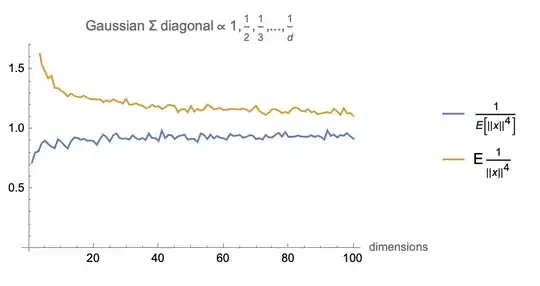

Numerical simulation suggests the limit in question might be equal to $1$, any tips?
