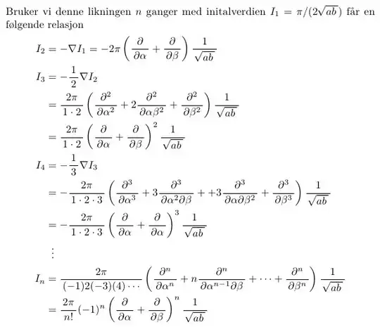

Here is a different solution using differentiation under integral sign. We firstly look at the the case $n=1$, then \begin{align*} I_1(\alpha,\beta) & = \int_{0}^{2\pi}\frac{dx}{\alpha \cos^2x+\beta \sin^2x} \\ & = \int_{0}^{2\pi} \frac{\sec^2x}{\alpha + \beta \tan^2x} \,\mathrm{d}x\\ & = \frac{1}{\beta} \int_0^{2\pi} \frac{1}{\left(\sqrt{\frac{\alpha}{\beta}}\right)^2 + \tan^2 (x)}\; \mathrm{d}(\tan x)\,\\ & = \frac{1}{\sqrt{\alpha \beta}} \left[ \left(\tan^{-1}\left(\sqrt{\frac{\beta}{\alpha}}\tan (x)\right)\right) \right]_0^{2\pi} = \frac{2\pi}{\sqrt{\alpha\beta}} \end{align*} Where $a^2 = \alpha$ and $b^2 = \beta$. Differentiating $I_n$ with respect to $\alpha$ and $\beta$ yields \begin{align*} \frac{\mathrm{d}}{\mathrm{d}\alpha} I_n & = - \int_0^{2\pi} \frac{n \cos^2x}{(\alpha \cos^2x + \beta \sin^2x)^{n+1}} \\ \frac{\mathrm{d}}{\mathrm{d}\beta} I_n & = - \int_0^{2\pi} \frac{n \sin^2x}{(\alpha \cos^2x + \beta \sin^2x)^{n+1}} \end{align*} Addition gives that \begin{align} \nabla I_n = \left( \frac{\mathrm{d}}{\mathrm{d}\alpha} + \frac{\mathrm{d}}{\mathrm{d}\beta} \right) I_1 = -n \int_0^{2\pi} \frac{(\sin^2x + \cos^2x)\mathrm{d}x}{(\alpha \cos^2x + \beta \sin^2x)^2} = -n I_{n+1} \end{align} Where $\nabla$ is the nabla-operator. This gives us the recurrence relation \begin{align} \nabla I_{n-1} = (1-n) I_n \tag{1} \end{align} Which can be used to evaluate each $n \in \mathbb{N} / \{ 1 \}$. This is a fine answer, but if one wants an explicit expression it can be shown by induction that $$ \boxed{ \displaystyle I_{n+1} = \frac{2\pi(-1)^{n}}{n!} \left( \frac{\partial }{\partial \alpha} + \frac{\partial}{\partial \beta} \right)^n \frac{1}{\sqrt{\alpha\beta}} } $$ Where the last part is the binomial expansion of the partial derivatives, and this holds for all $n \in \mathbb{N}$. Example for $n=3$ we have $$ \left( \frac{\partial }{\partial \alpha} + \frac{\partial}{\partial \beta} \right)^2 f(\alpha,\beta) = \left(\frac{\partial^2}{\partial \alpha^2}+2\frac{\partial^2}{\partial \alpha \, \partial \beta}+\frac{\partial^2}{\partial \beta^2}\right)f(\alpha,\beta) $$ We can also express the partial derivatives as a sum like $$ \left( \frac{\partial }{\partial \alpha} + \frac{\partial}{\partial \beta} \right)^n = \sum_{k=0}^b \binom{n}{k} \frac{\partial^{n-k} }{\partial \alpha^{n-k} } \frac{\partial^{k} }{\partial \beta^{k} } = \sum_{k=0}^\infty \binom{n}{k} \frac{\partial^{n} }{\partial \alpha^{n-k} \,\partial^k \beta} $$ without that doing us much good. For actually computing explicit values of $n$ the recurrence relation is more convenient.
EDIT: To give an intuition of the "closed" expression one can first rewrite $(1)$ to $$ I_n = - \frac{1}{n-1} \nabla I_{n-1} $$ Direct computation of the first values gives Proof of J One can also show that the expression satisfies $(1)$ directly by insertion, and the use of the chain rule.
  • Where you perform the differentiation, you say that you're going to do so with respect to $a$ and $b$, but you write $\alpha$ and $\beta$ in the derivative operators. Which are you doing? – apnorton Jul 31 '13 at 21:09
  • Of course differentiating $\alpha$ and $\beta$, fixed the minor typos. Fixed the formula as well, I can not be bothered writing out the induction proof, but if someone else wants to feel free =) – N3buchadnezzar Jul 31 '13 at 21:19
  • thanks but how can you prove $$ \boxed{ \displaystyle I_{n+1} = \frac{2\pi(-1)^{n}}{n!} \left( \frac{\partial }{\partial \alpha} + \frac{\partial}{\partial \beta} \right)^n \frac{1}{\sqrt{\alpha\beta}} } $$ with inuction at first then if you can prove it without induction – mnsh Jul 31 '13 at 22:42
    You can prove that expression by checking that it satisfies the expression $\nabla I_{n-1} = (1-n) I_n$. As in plugging it into the relation. I also added some information about the intuition behind the formula. Hope this helps. – N3buchadnezzar Aug 04 '13 at 10:50
