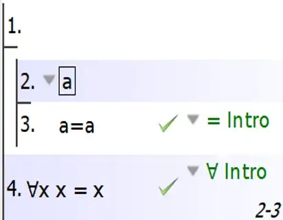

Since it is a logical theorem, it can be proven using no assumptions whatsover. Hence, there is no need to include it in any set of axioms.
How to prove it? That depends on the specific rules of the proof system you are working with. Here is a formal proof in Fitch:
