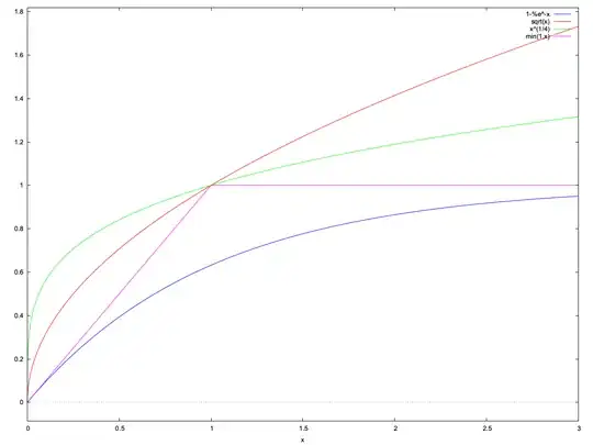

For $0 \le \lambda \le 1$ is $$ 1 - e^{-\lambda} \le \lambda \le \lambda^\alpha \, , $$ for the first inequality see for example Simplest or nicest proof that $1+x \le e^x$.
And for $\lambda > 1$ is $$ 1 - e^{-\lambda} < 1 < \lambda^\alpha \, . $$
The following plot of $1-e^{-x}$ (blue), $\min(1, x)$ (purple), $x^{1/2}$ (red) and $x^{1/4}$ (green) shows the idea:
