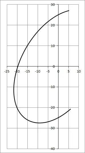

As a numerical example, let the original ellipse have $a = 30, b = 18, \theta = \dfrac{\pi}{3}$, and let $\phi_s = \dfrac{\pi}{6}=0.5235987$ and $\phi_e = \dfrac{4 \pi}{3}=4.18879 $, and let the transformation matrix be
$ A = \begin{bmatrix} 2 && - 3 \\ 1 && 5 \end{bmatrix} $
The original elliptical arc in shown in the first figure in black.

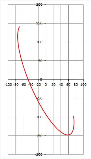

The transformed ellipse is drawn in blue in the following figure which was generated using the conjugate radii $\mathbf{f_1}$ and $\mathbf{f_2}$.
Next, to plot the transformed arc using it perpendicular semi-axes, the corresponding transformed angles are computed using the above formula to be
$ \phi'_s = 1.775725 $ and $ \phi'_e = 5.440917 $
Using these values, the transformed ellipse is plotted (in red).
As can be seen, the two arcs are identical.
