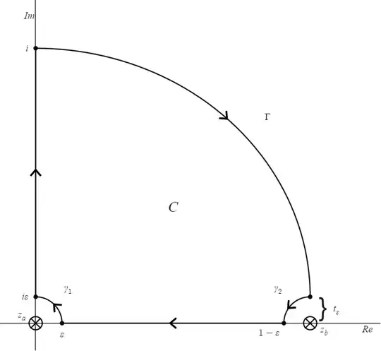

Below is a visual of $C$. One of my best friends Dairah coded this, so credit to her.
By Cauchy's Residue Theorem, we get $\oint_C f(z)dz$ to be $$ \eqalign{ 0 &= \int_{1-\epsilon}^{\epsilon}f(x)dx + \int_{\gamma_1}f(z)dz + \int_{i}^{i\epsilon}f(z)dz + \int_{\Gamma}f(z)dz + \int_{\gamma_2}f(z)dz \\ \int_{\epsilon}^{1-\epsilon}f(x)dx &= \int_{\gamma_1}f(z)dz + \int_{i}^{i\epsilon}f(z)dz + \int_{\Gamma}f(z)dz + \int_{\gamma_2}f(z)dz. \\ } $$ Taking the limit as $\epsilon,t_{\epsilon} \to 0$ on both sides, we get $$ J = \lim_{\epsilon \to 0}\int_{\gamma_1}f(z)dz + \lim_{\epsilon \to 0}\int_{i}^{i\epsilon}f(z)dz + \lim_{t_{\epsilon} \to 0}\int_{\Gamma}f(z)dz + \lim_{\epsilon \to 0}\int_{\gamma_2}f(z)dz. $$
