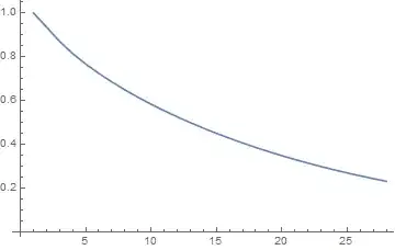

For connectivity in particular, the problem is simple enough that we can find an expression for the exact probability that $G(n,p)$ is connected in terms of $n$ and $p$. So we can look at the actual answer to your starting question: what is the probability that $G(n,\frac3n)$ is connected in terms of $n$? Here is a plot of that probability, for $3 \le n \le 30$:
You can see that the probability decreases very smoothly and nothing special happens when $n=20$. (Actually, for deeper reasons, that is about where the probability passes $\frac1e \approx 0.37$, but I don't think that's what you expected, and this does not generalize to other thresholds.)
The probability of not having isolated vertices will have a very similar plot; even for $n$ in this range, having an isolated vertex is by far the likeliest way for a graph not to be connected.
So you see that it does not even make sense to ask a question like "for what $n$ can we say that other components have appeared?" There is not going to be a point at which that probability suddenly jumps from $\approx 0$ to $\approx 1$; there will be a smooth change over many values of $n$.
