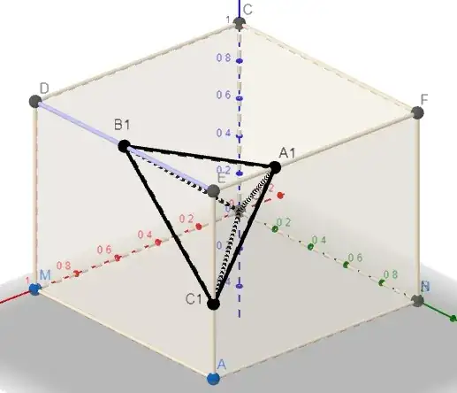

This question can be treated in a different way, by somehow "making the exponential disappear". Here is how.
Setting
$$a=e^{-A}, \ \ b=e^{-B}, \ \ c=e^{-C},$$
the inequality to be proven is
$$\forall a,b,c \in [0,1], \ \ abc \ge a+b+c-2$$
But this is a consequence of the following determinant inequality:
$$\forall a,b,c \in [0,1], \ \ \begin{vmatrix}a&1&1\\1&b&1\\1&1&c\end{vmatrix} \ge 0 \tag{1}$$
to which we give a graphical proof: indeed this determinant is equal to 6 times the volume of the positively oriented tetrahedron $OA_1B_1C_1$ (with points $A_1,B_1,C_1$ having the columns of the determinant as their coordinates) represented in the following figure:
Remarks:
  1. Inequality (1) becomes an equality if and only if $a=b=c=1$.
  2. (1) is extensible to any dimension.
