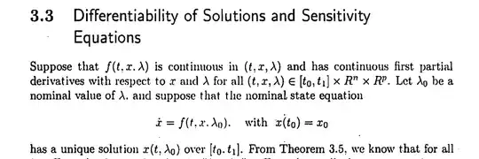

I am reading about sensitivity equations. In the book by Khalil they write
Khalil
and go on to derive the sensitivity equations.
