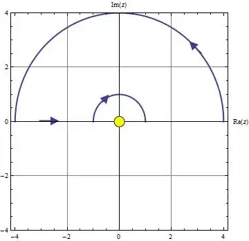

Consider the contour integral
$$\oint_C dz \frac{(z^2+a^2) e^{i z}}{z (z^2+b^2)}$$
where $C$ is the semicircular contour of radius $R$ in the upper half-plane, with an additional semicircular contour of radius $\epsilon$ centered at the origin, jutting into the upper half-plane.
The contour integral is equal to
$$\int_{-R}^{-\epsilon} dx \, \frac{(x^2+a^2) e^{i x}}{x (x^2+b^2)} + i \epsilon \int_{-\pi}^0 d\phi e^{i \phi} \frac{(a^2+\epsilon^2 e^{i 2 \phi}) e^{i \epsilon e^{i \phi}}}{\epsilon e^{i \phi} (b^2+\epsilon^2 e^{i 2 \phi})}+\\\int_{\epsilon}^R dx \, \frac{(x^2+a^2) e^{i x}}{x (x^2+b^2)}+i R \int_0^{\pi} d\theta e^{i \theta}\frac{(a^2+R^2 e^{i 2 \theta}) e^{i R e^{i \theta}}}{Re^{i \theta} (b^2+R^2 e^{i 2 \theta})} $$
We take the limit as $R \to \infty$ and $\epsilon \to 0$ and get
$$PV \int_{-\infty}^{\infty} dx \, \frac{(x^2+a^2) e^{i x}}{x (x^2+b^2)} - i \pi \frac{a^2}{b^2}$$
