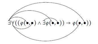

In a formal language $\mathcal{L}$, individual constants are items of non-logical vocabulary and designate specific members of the structure's domain of discourse. Variables are items of logical vocabulary and either stands for an indeterminate member in the domain as a constituent of an open formula or sweeps over the domain (again actually, indeterminately) as a constituent of quantification. A view to better grasp the variables is due to Quine. According to Quine (Mathematical Logic revised edition, p.70):
The variables have no meaning beyond the pronominal sort of meaning which is reflected in translations [. . .]; they serve merely to indicate cross-references to various positions of quantification.
Hence, variables fulfil a cataphoric role that can be illustrated (indeed, replaced) by a diagram. I borrow an example from Button and Walsh's Philosophy and Model Theory (p. 14), since it is plainer and clearer than Quine's (I'd be grateful if anyone supplies MathJax code for it). Thus,
$$\exists x\forall y((\phi(x, y)\wedge\exists z\phi(x, z))\rightarrow\phi(y, x))$$
can be represented as
Consequently, in case that we need to designate a specific member of the domain, we have to conjure up a formula that defines it (see my post). However, if the member is not definable in the language, then we have to appeal to the extra-logical method and add the member among the individual constants.
