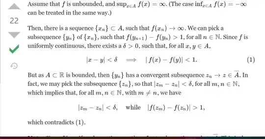

Is the highlighted part wrong?
were trying to show that the function $f(x) = \tan x$ on $[0,\frac {\pi} 2)$ is not uniformly continuous by using the fact that "if $f$ is uniformly continuous on a bounded set $S$, then $f$ is a bounded function on $S$."
What I don't get is both quizlet and chegg are claiming that $[0,\frac {\pi} 2)$ is a bounded set, when it isn't.
I showed that $f(x) = \tan x$ is an unbounded function on $[0,\frac {\pi} 2)$ hence $f(x)$ cannot be a uniformly continuous on a bounded set $[0,\frac {\pi} 2)$. Yet $[0,\frac {\pi} 2)$ isn't bounded? I don't get this.

  • They’re hilighting $[0,\pi/2)$, no mention of infinity? – FShrike Sep 05 '22 at 06:35
  • yeah just fixed that mb – kenko Sep 05 '22 at 06:35
    You might be confusing boundedness with closedness (or openness). Boundedness is just about whether the set goes off to infinity or not. – Ravi Fernando Sep 05 '22 at 06:45
  • oh ok i get the definition now. I just rechecked the completeness axiom 4.2 def from textbook and that checks out. on wikipedia it says "bounded intervals are bounded sets" but a bounded interval must be upper and lower bounded. so its a unbounded interval hence unbounded set. So a unbounded interval != unbounded set right? – kenko Sep 05 '22 at 06:48
  • yeah i was getting confused with the closedness or openness. thx – kenko Sep 05 '22 at 06:50
A set is bounded if it has both upper and lower bounds, i.e. if there are values $l$ and $u$ such that every element $x$ from the set satisfies $l \leq x \leq u$. The interval $[0, \frac{\pi}{2})$ is bounded - it has a lower bound of $0$ and an upper bound of $\frac{\pi}{2}$. (It has many bounds, in fact, but these are the tightest ones.)
It's true that the interval does not have a maximum element, because its supremum (aka its least upper bound) lies outside the interval itself, but that's a different property.
