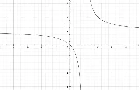

$\rm\color{#c00}{Descent}$ is via $\rm\color{#0a0}{reflection}$ symmetry on hyperbola $\,\cal C\!: x+y = xy,\,$ i.e. $(x,y)$ on $\cal C\Rightarrow \color{#0a0}{(y,x)}$ on $\cal C$. Thus if $\,(a,b)\in\Bbb N$ and $(a,b)$ on $\,{\cal C}\,\ \color{#90f}{{\rm has}\ a> 2}$ then $\,\color{#c00}{b < a}\,$ so its reflection $\color{#0a0}{(b,a)}$ has $\rm\color{#c00}{smaller}$ $x$ coordinate. We can repeat this descent step again on $(b,a)$ and again $\,\ldots$ (i.e. infinite descent) since $\color{#90f}{{\rm also}\ b > 2}$ (else we get contradictions: $\,b\!=\!2\Rightarrow a\!=\!2;\ $ $b\!=\!1\Rightarrow a\!+\!1 = a;\ $ $b\!=\!0\Rightarrow a\!=\!0)$.
Remark $ $ Generally (reflection) symmetries govern descent on integer points on conics - see the links I give here in the context of less trivial Vieta jumping reflection symmetry.
$$\bbox[5px,border:2px solid #000]{\text{the hyperbola}\,\ x+y = xy}$$
