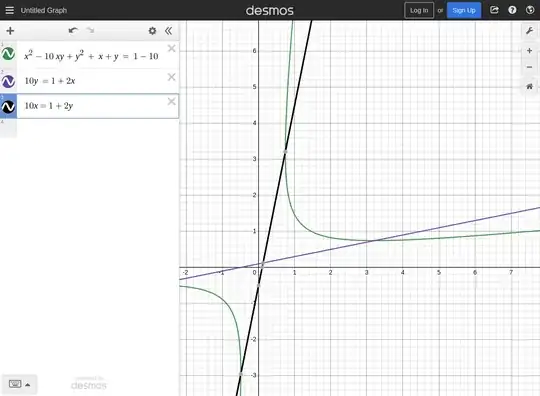

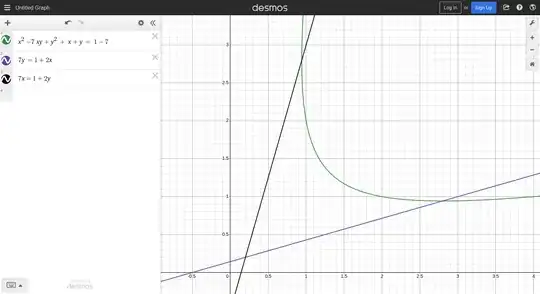

there are just two flavors of these; For integer $k$ we are looking for integer points on the arc of $$ x^2 - kxy + y^2 + x + y = 1 -k $$ between the lines $ky = 1 + 2x$ and $kx = 1+2y$
For $k > 7$ the arc includes a point $(t,t)$ with $1 < t < 2$
Calculation will show that, for $x=2,$ we have $y < 1,$ and the (local) minimum $y$ occurs exactly where the line $ky = 1+2x$ intersects the hyperbola.
Here is $k=10$

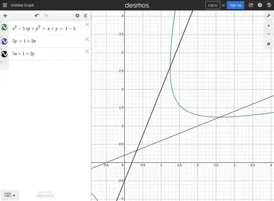

for $k < 7$ the local min is above $1$ but the slanted lines are closer together...
I mention a second flavor, those are when $ x^2 + kxy + y^2$ is some small number and the picture is rotated.
