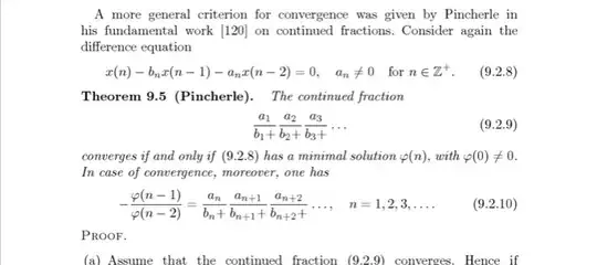

Image from Introduction to Difference Equations by S. Elaydi:
S Elaydi

  • Aha! I will look into this Pincherle result. – FShrike Aug 28 '22 at 11:17
  • It’s not immediately obvious in what sense a solution is “minimal”. I don’t know if I’d need to scroll through the whole book to find this. Does it just want $\varphi(n)$ to attain the smallest possible values? – FShrike Aug 28 '22 at 11:20
  • It seems section 9.6 "Minimal Solutions, Continued Fractions, and Orthogonal Polynomials" is the place to look. But page 422 is not in the free preview. Also the references are not in the free preview to help us find the paper of Pincherle. – GEdgar Aug 28 '22 at 11:28
  • Found the reference for Pincherle. Added. – GEdgar Aug 28 '22 at 11:43
  • Excellent. You can find the text here. I’ll have a look through and hopefully their work contains nice sufficient conditions! Thank you for this research – FShrike Aug 28 '22 at 11:47
